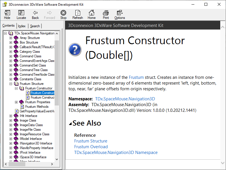

I also have issue with help files included in the SDK. Those are compiled ".chm" files and somehow on multiple computers with Windows 10 they open only topic titles, but topic content remains completely empty. Is there a bug in those files? All of them are like that.
What SDK package are you looking at? I just opened the doc/Documentation.chm in the package of SDK v. 4.0.2 on a development machine (Windows 10 x64 version 20H2) and all seems well (see below screenshot).

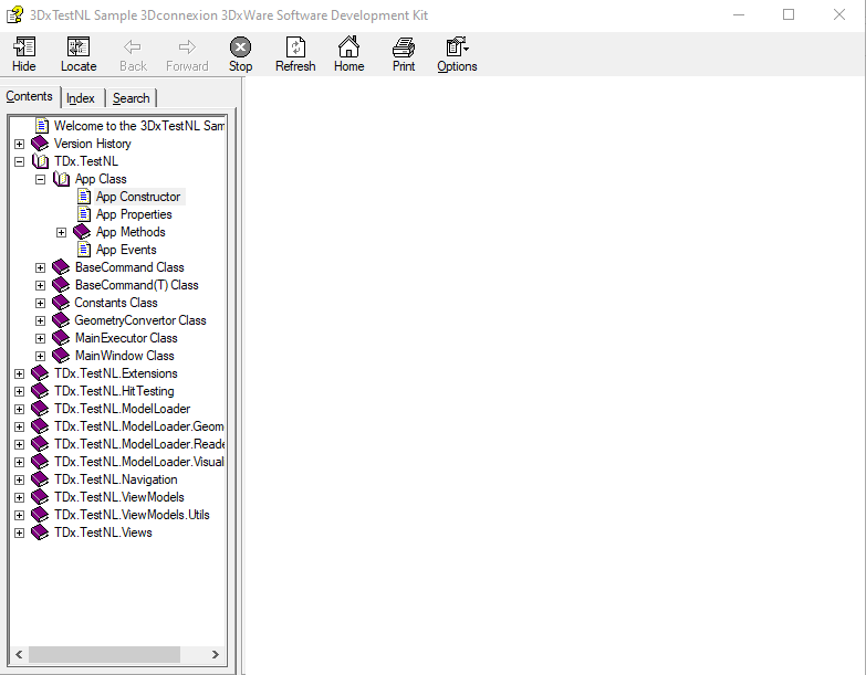

This is puzzling. I'm using latest downloaded SDK 4.0.2. Just downloaded it again (.zip file 3DxWare_SDK_v4-0-2_r17624.zip).
After unzipping i went to V:\Temp\samples\3DxTestNL\Documentation.chm

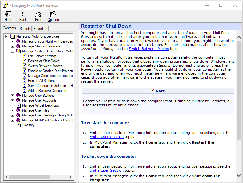

It opens topic titles but not topic content - see attached screenshot. Tried on three different computers all latest Windows 10.

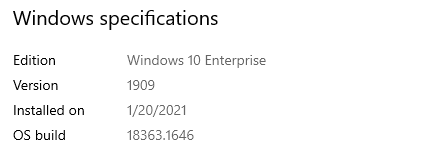

The one I'm writing is Microsoft Windows [Version 10.0.18363.1646]. Attached is screenshot of what I'm getting. No matter what topic I choose, the effect is the same. Also other ".chm" files from the sdk have the same effect. ".chm" files from other programs open with no issues on the same machines. Here is an example just now on this machine. I opened one of the Microsoft Windows ".chm" files found in C:\Windows\... folders. Attached second screenshot shows no issue.

I'm using latest SDK. I tried 3 computers, all latest Windows 10. This third one just downloaded SDK again: 3DxWare_SDK_v4-0-2_r17624.zip
The computer windows version is Microsoft Windows [Version 10.0.18363.1646]

Any ".chm" file in the SDK displays only topic title but not content, for example :
Screenshot 2021-07-20 140919.png (37.99 KiB) Viewed 29490 times

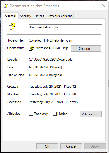

Well, the file matches. The size is 625639 and MD5 code is fc00d6b49b784d9cf3588b52f54388f1. This is the same you posted but this file on three different computers does not show any topic content (nor any other ".chm" file from the SDK for that matter). I tried it to open on my work issued laptop with Windows 10 Enterprise, personal laptop with Windows 10 Pro and personal desktop with Windows 10 Pro to no effect. Each one has its own separate Windows installation not related to each other.

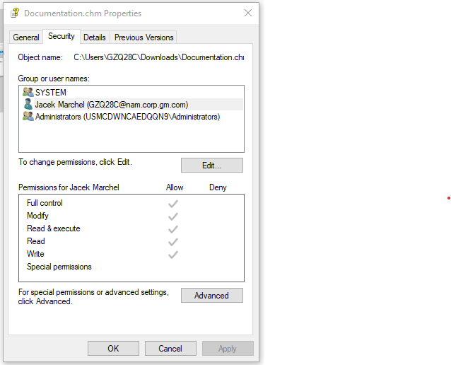

I have full control of the file:
Screenshot 2021-07-21 064206.png (29.07 KiB) Viewed 29482 times
The file is not compressed or encrypted. Only archive and allowing for content indexed attributes are set.
