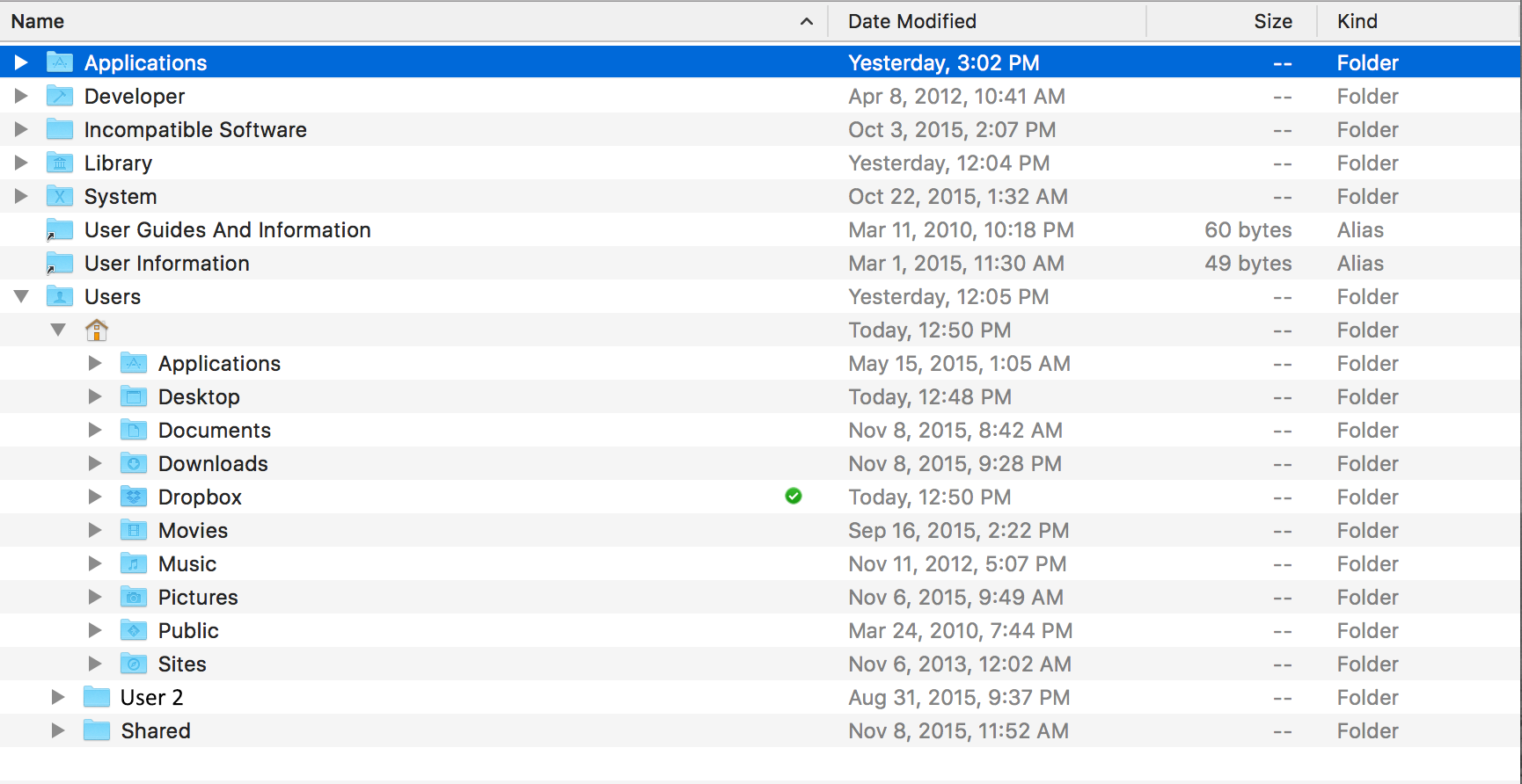

Thank you for the response. I don't have any of the directories or files that you referenced after uninstalling driver 10.2.4.
Attached is a screenshot of my root directory.
Any other suggestions?
Thanks in advance.

Your screenshot has the Library folder. Open that and you should find ~/Library/Preferences/.
[The [~] is for Home so that you are in your ~ /Library/Preferences - rather than in the system's /Library/Preferences folder]
In ~/Library/Preferences you should see the filenames starting with 'com.3dconnexion' and ending with '.plist' from Uta's post.
Then open the /Saved Application States folder for the listed files there beginning with 'com.3Dconnexion'.
Barbara

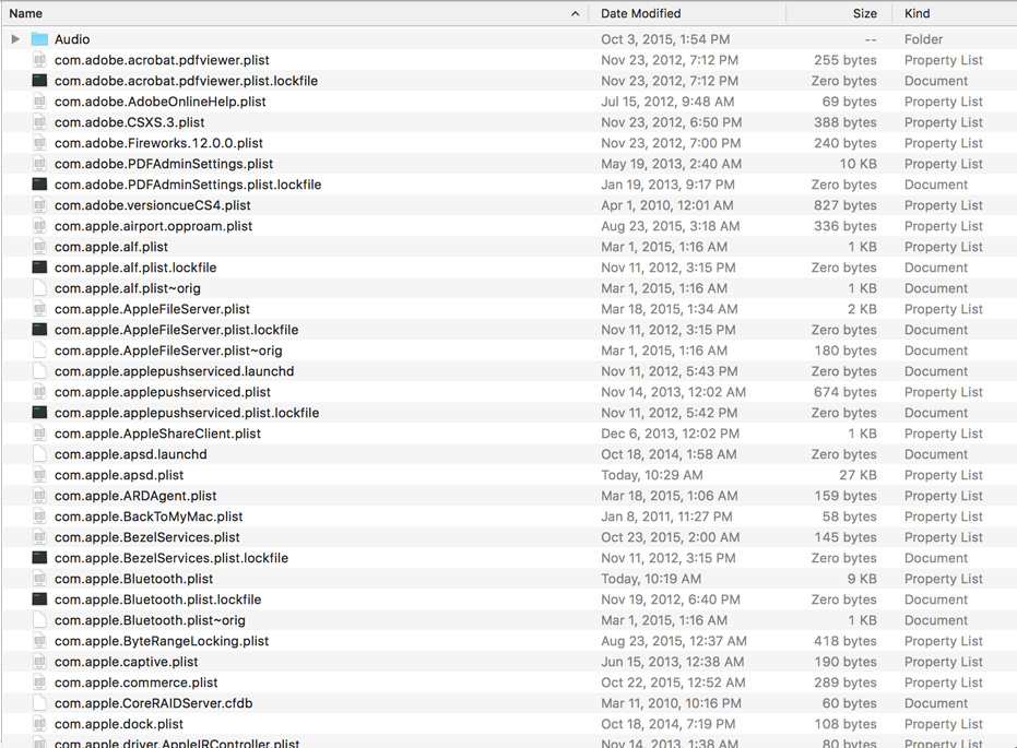

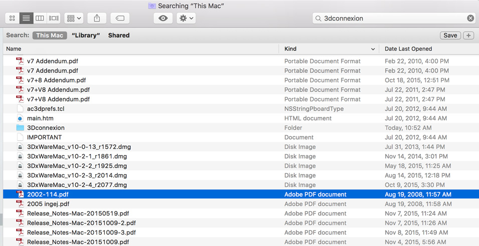

I've looked in the ~/Library/Preferences folder and there are no 3dconnexion files in that folder.
Also searched the entire file system and there are no .plist files associated with 3dconnexion.
Suggestions?

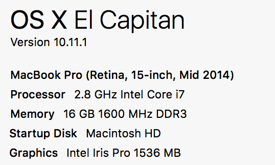

Here's my machine details if needed.
Screen Shot 2015-11-13 at 12.17.38 PM.png (46.92 KiB) Viewed 13902 times
My MacPro at the home office does NOT have this issue. Both my Macbook and MacPro are running El Capitan.
