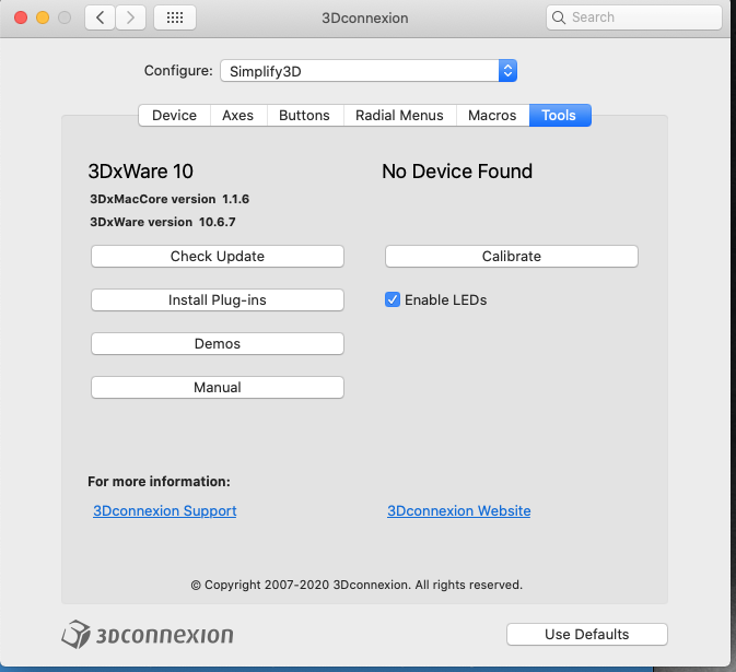

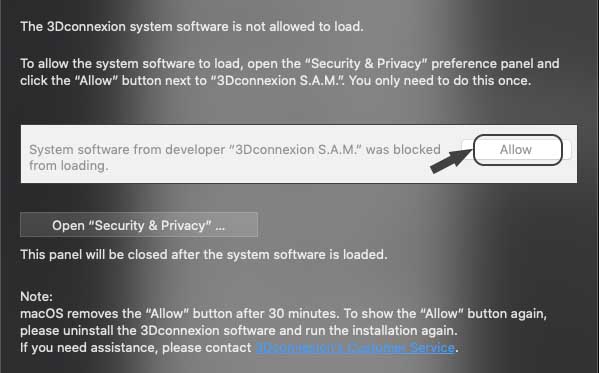

I've just developed a problem with my SpaceNavigator not acting right with my computer... it's acting like a normal mouse in my 3D design software... And now when I reboot, there screen says "The 3Dconnexion software is not allowed to load" and it gives me a link to click to get to my "security & privacy" preference panel... but the "Allow 3Dconnexxion S.A.M." is not showing as an option... I"m stuck... the 3Dconnexion software is saying I don't have a device connected... I can't calibrate or turn the LEDs on and off anymore (they're on)... and worst off.. I can't use it in the software I need it to work with!!!
I've uninstalled the software and drivers several times... but the option is still not available in the "S&P" panel
HELP!!!
Thank you

Darcsyde wrote: Sat Feb 06, 2021 10:44 pm now when I reboot, there screen says "The 3Dconnexion software is not allowed to load" and it gives me a link to click to get to my "security & privacy" preference panel... but the "Allow 3Dconnexxion S.A.M." is not showing as an option...
Answered here.
