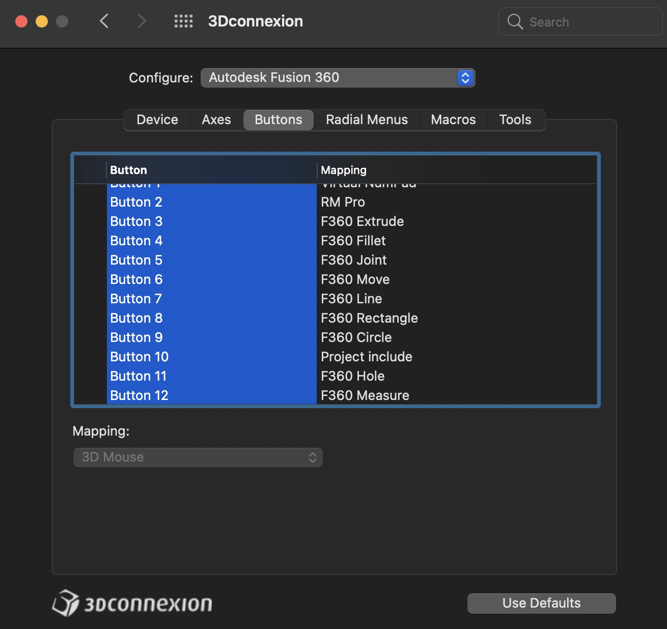

KlaudioPer wrote: Thu Dec 03, 2020 1:24 am I installed the beta 8 (r3277) on my SME and the buttons from 1 to 12 are still NOT working, each of them doesn't respond to the commands associated on the display. Testing it on Fusion 360
Any thoughts ?
Can you tell me what is assigned to a button that does not work?
here is a screenshot of my settings, besides the Virtual NumPad which is assigned by default to B#1, NONE of them are working, but they just open "Material Appearance" in Fusion 360

KlaudioPer wrote: Fri Dec 04, 2020 1:55 am [here is a screenshot of my settings, besides the Virtual NumPad which is assigned by default to B#1, NONE of them are working, but they just open "Material Appearance" in Fusion 360
Thanks for the screenshot, KlaudioPer. Apparently, the buttons are working but the assigned actions are failing to execute as expected. This may indicate an incorrect default configuration for Fusion 360 and not a driver issue with the low-level code handling the buttons of your device.

ngomes wrote: Fri Dec 04, 2020 2:14 am
Hello ngomes,
what does " low-level code handling the buttons of your device" mean? How can be an incorrect default configuration for Fusion 360? This is the standard configuration that comes with the SME, the only one assigned by me is the #10 Project Include.
Also I just noticed that "Shift" and "CTRL" buttons are not working as well.
What should I do ?

KlaudioPer wrote: Fri Dec 04, 2020 2:28 am What should I do ?
Other than having to wait until we correct the default configuration for Fusion 360, there isn't much you can do. What you can consider is assign a keyboard shortcut to the SME buttons to activate the application commands you require. The buttons "1" through "12" can be reassigned.
