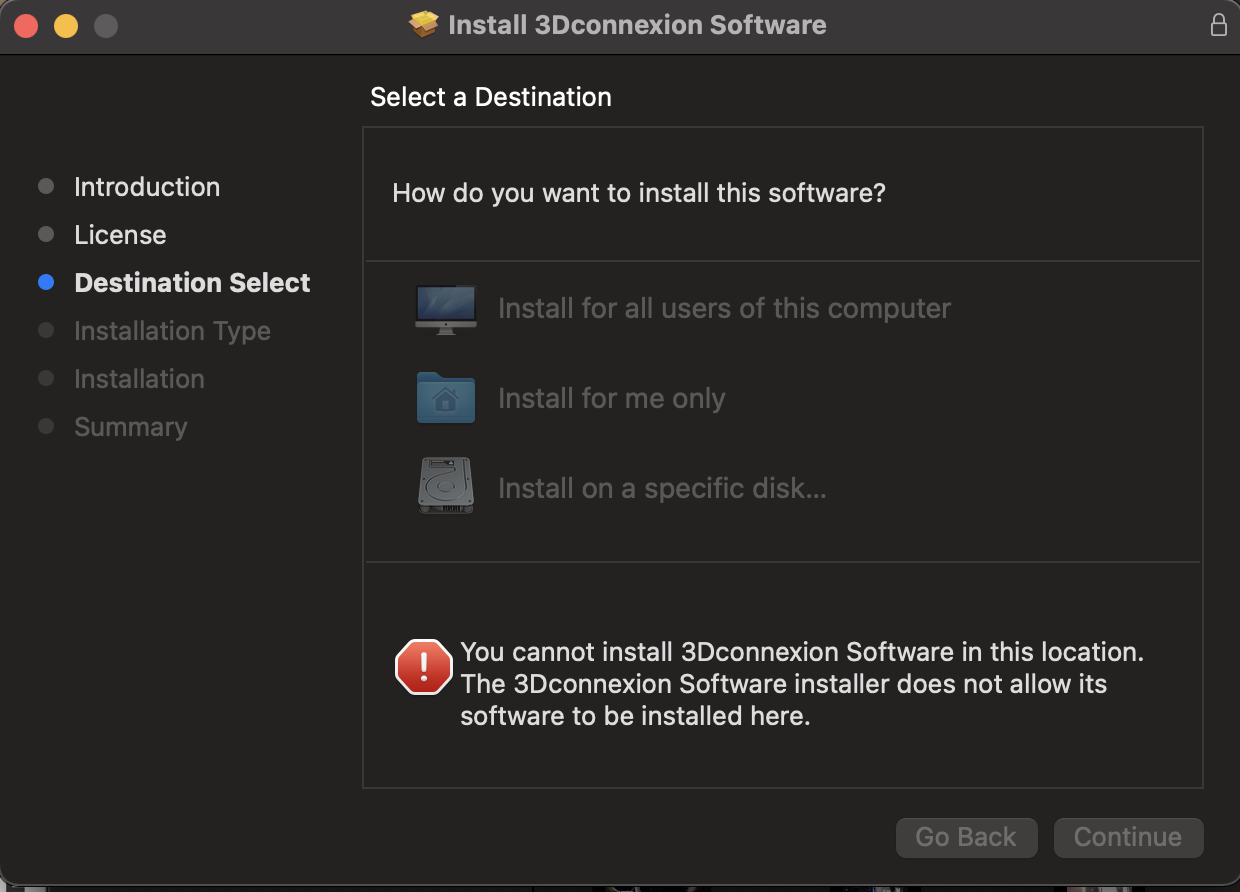

I am trying to download the new driver ( 10.6.7) release date 12/16/2020 for Mac
I get this error and cannot figure out how to allow access for 3d connexion to download.
I have attached a screenshot of the error.

Hi CHICKOS,
What system version are you using?

Big Sur 11.1

CHICKOS wrote: ↑Thu Dec 17, 2020 7:56 amBig Sur 11.1
The error you are seeing ("You cannot install 3Dconnexion Software on this location") is the expected behaviour when attempting to install driver v. 10.6.7 on macOS 11 and newer.
For macOS 11 and newer, driver version 10.7.0 is required. The new driver is currently in beta (more details here).

Ok, I have the beta and was told a version release will be out in December and have been checking daily as the buttons do not work.
I did not see the Beta link and thought it was the new release.

CHICKOS wrote: ↑Thu Dec 17, 2020 10:11 am I did not see the Beta link and thought it was the new release.
It's never easy to find. That's why we added the OS version check in the installer precisely to avoid installing an invalid driver.
Unfortunately, the installer message of "cannot install xyz in this location" isn't particularly helpful.
