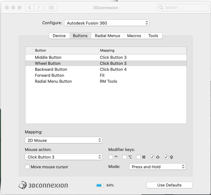

I spent quite some time trying to find the best way to achieve orbit on the CadMouse middle button or wheel button and couldn't find anything as simple as this method.
By toggling BOTH shift and shift lock on the modifier keys area for the button click, you can get Orbit to work with a single press.
Screenshot 2021-01-21 at 16.58.06.png (62.8 KiB) Viewed 4864 times
Hope that helps!
