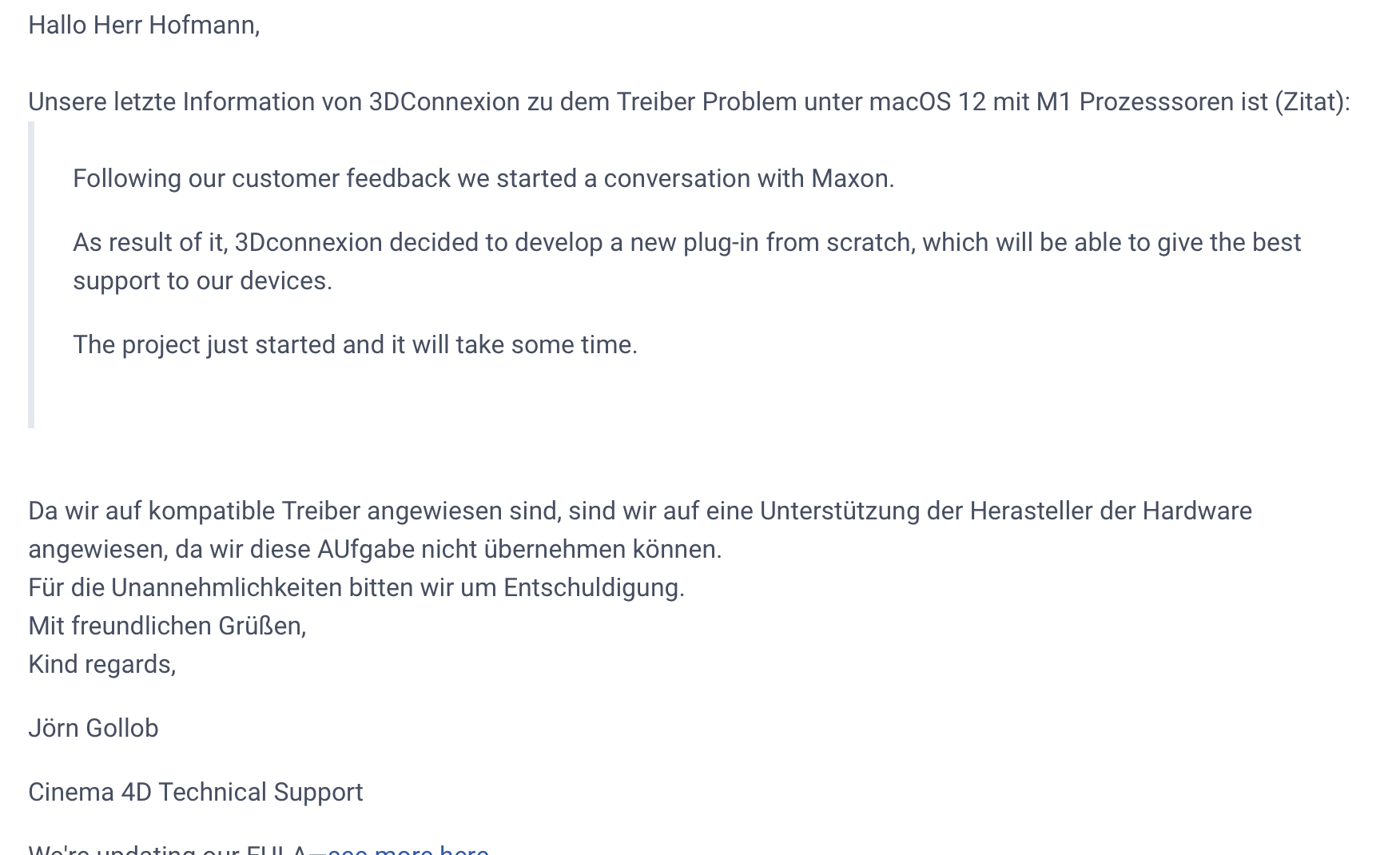

The 3D mouse no longer works with Cinema 4D on an M1 Mac. Unfortunately I got the information from Maxon that this is due to the driver of the mouse. I hope that I do not get the information here that it is the manufacturer of Cinema 4d. As a user, one wonders why it doesn't just work that the manufacturer of a 3D mouse and the manufacturer of a software together take care of such a problem. For a year now I have been annoyed with this problem. I have two 3D mice that I can now probably just throw in the trash can.
I attach the answer I got from the Maxon support.
Bildschirmfoto 2022-04-26 um 09.41.32.png (192.96 KiB) Viewed 139275 times

Thanks for sharing the update. Frustrating to say the least - I just bought one today for the sole purpose of C4D...
Usually when they say "soon" it means about 6 months to a year, so I can only imagine what "will take some time" means.

SpaceMouse support for Cinema 4D is implemented in the application, not in a 3Dconnexion add-in or similar solution. This is a known issue since at least late 2021:
ngomes wrote: ↑Tue Dec 07, 2021 8:40 am
dsveInc wrote: MAC-318 (Cinema 4D R25 does not work on M1 machines)
As far as we can tell, Cinema 4D R25 (native ARM64) has 3D mouse support disabled on M1 machines. The application does not attempt to open a connection to the driver. We have reached out to Maxon and we will determine where precisely is the problem (driver or application) when they can look into to our request.
In other words, the decision to block SpaceMouse support on the ARM64 builds (M1) of Cinema 4D was made by the software vendor, not 3Dconnexion. We cannot speculate why this decision was made but we are actively engaging with Maxon to restore the functionality.

kasteph wrote: ↑Wed Jul 13, 2022 9:06 pm to make up for an unfinished driver
As mentioned above, the vendor blocked support for SpaceMouse devices in the Cinema 4D build for the M1. It's not the driver that is the issue here.
3Dconnexion is actively engaging with Maxon to resolve this but it will require an update to the application. Once we have more information to share on this issue, we will do so.

In my 20 April mail to Maxon and 3D Connexion CEOs I got the immediate answer from Antonio Pascucci (Vice President Products at 3Dconnexion) -- quoted in this forum already:
Dear Stephan,
Following our customer feedback we started a conversation with Maxon.
As result of it, 3Dconnexion decided to develop a new plug-in from scratch, which will be able to give the best support to our devices.
The project just started and it will take some time.
Best,
Antonio
Jörn Gollob from Maxon has been writing to our team in April as well:
Unfortunately devices from 3dconnexion does currently not support full M1 hardware and needs to be adapted first.
Only to read later on in this forum that the issue is on Maxons side.
Seriously -- is this a political issue between Maxon an 3D Connexion?
