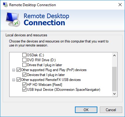

On opening the remote desktop I get:

I got the RDP portion to work. I can go to local resources > more and the category for other supported RemoteFX usb devices. Even lists "USB Input Device (3Dconnexion SpaceMouse Pro) but when I connect to the remote pc with RDP, it's not forwarding. Driver is installed on both machines, works fine on the local pc it's plugged into, but the remote pc doesn't see it
Is there something I'm missing?

There should be a blue connection bar at the top of your remote desktop screen. You can unpin it but I have left it visible at all time. At the top left I have 4 icons. Before setting the 3d mouse up I only had 3. The new one is the printer icon to the right of the connection strength bars icon. When I login I need to select the printer icon and tick the 3d mouse tick box.
If you haven't got this icon then there is an issue we can start to have a look at. It may be necessary for me to screen print each host and client dp edit setting relating to getting this to work.

Here are the two settings required on host computer and how to get there. This is on my computer at work (host) with my computer at home (client) that I am using with my 3d mouse
Other Notes:
1. Install 3d mouse driver on both host and client.
2. If you ever need an instant update on either machine of changes that you make to group policy editor (gepdit) type gpupdate /force at the the command prompt.
3. When opening the Remote Desktop, always check all options including in the drop down menu and tick all boxes.
