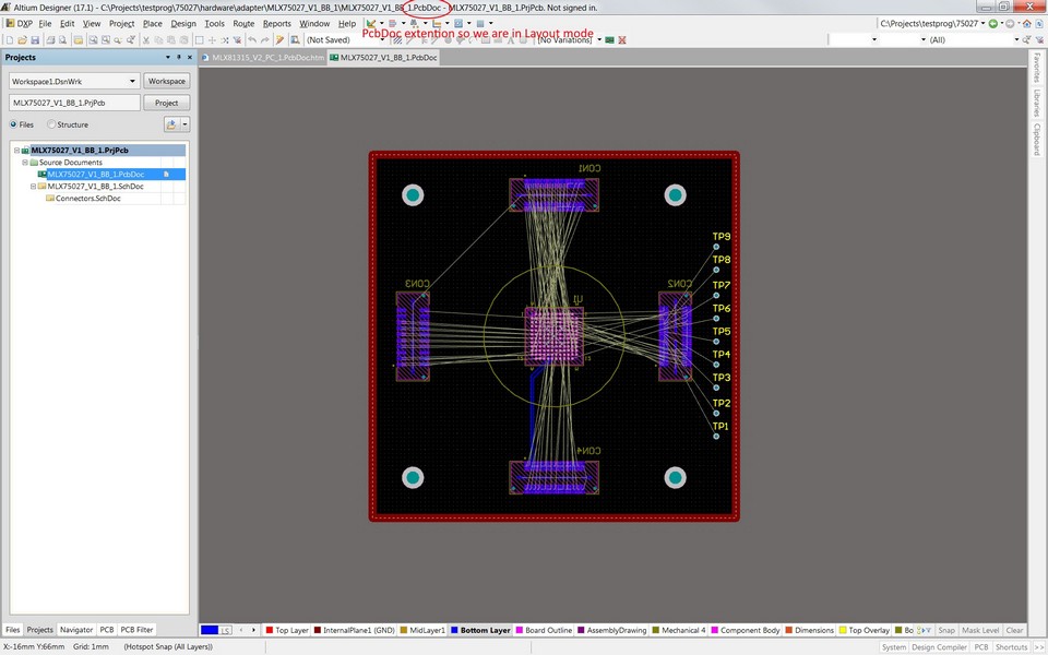

And also I see another way here.
Currently I'm able to set-up only one keyset for whole Altium both for Schematics and Layout mode. This is expecting behavior as in c:\Program Files\3Dconnexion\3DxWare\3DxWinCore64\Cfg\ we have single profile for Altium named AltiumDesigner.xml.
My idea here is to create different xml profiles which could analyze extension of opened file: *.SchDoc for Schematics mode and *.PcdDoc for Layout mode. Please see attached pictures for explanation.
So only one thing we need here: add needed Window Caption filtering into xml profile. Is it feasible to implement?

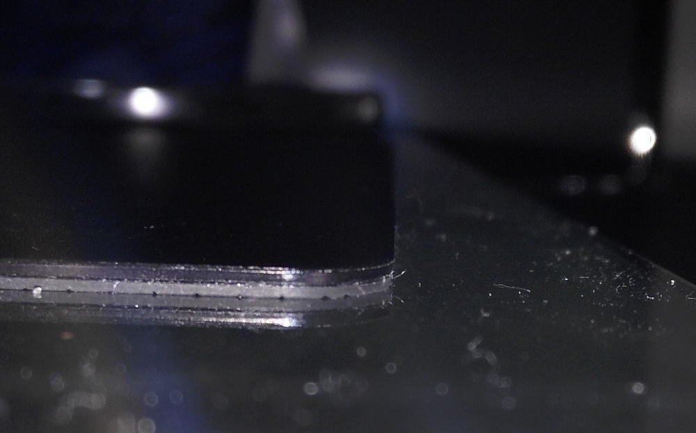

And one more on mousepad from Enterprise Kit. Sharp edge on solid plastic is not friendly to skin. Sharp edges on product for CAD guys... Seriously? :shock: What about chamfer? :D

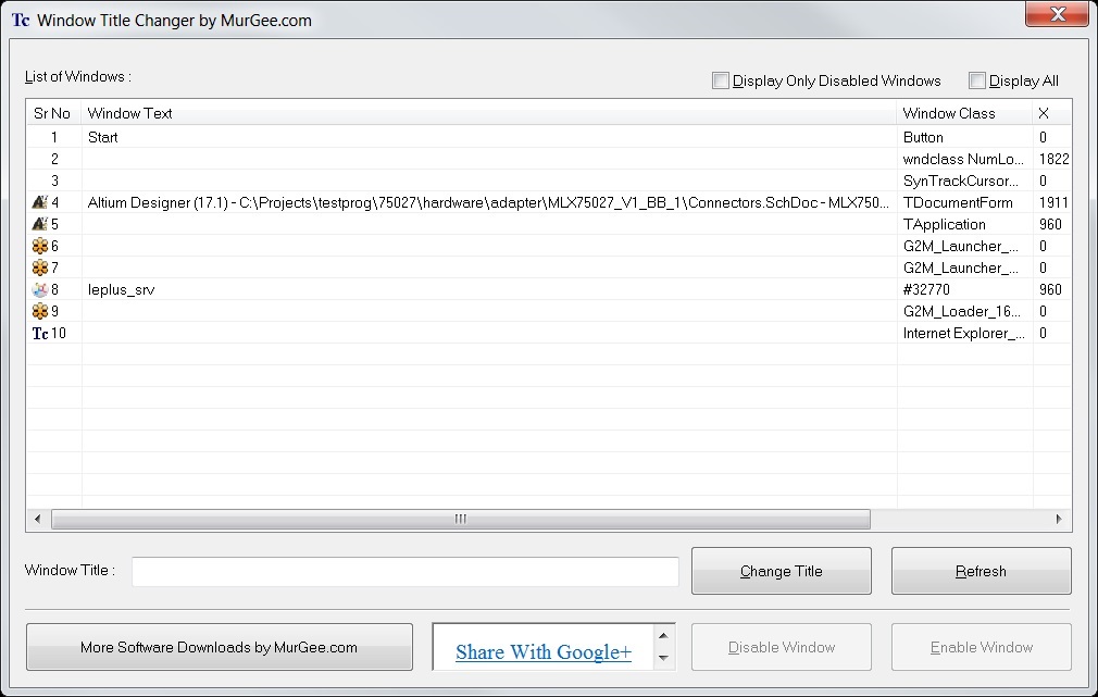

Unfortunately it doesn't work: now Altium not recognized, I see only DXP.EXE with common profile. So looks like Caption filtering doesn't work correctly.
Same time I use simple SW which show Window Caption and I see that string is present so should be accessible throw WinAPI. Please see attached screenshot.
