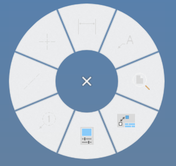

Is the a way to change colours of the backgound from the radial menus. With autodesk changing the icon of autocad they a washed out in the background as per the attachment.

It was a standalone install of product design suite 2019 - not an upgrade. Issue wasn't there in 2017. I have global menu transparency disabled and the only display setting I have changed is setting classic colours - which makes no difference if I set it to standard colours.
Many of the icons even looked washed out in the 3dxware settings as per the attachment.

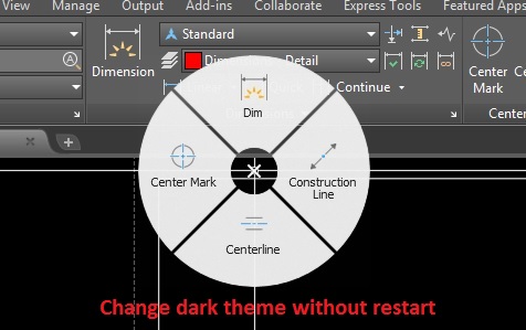

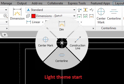

You need to resatart Autocad after changing the colour theme to see the results in the radial menus. If I just change to the dark theme without restarting it looks fine.
