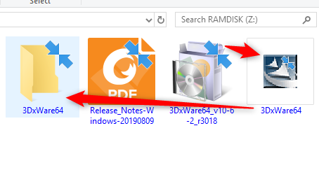

Modify your Windows OS' system variables' 'TEMP' and 'TMP' , change the variable value to, e.g., change them all to F:\Temp to shorten the length of the path where 3DxWare will be extracted to during the installation process. It's safe to do so.
Or you can just extract the 3DxWare driver via WinRAR or 7-ZIP, e.g., the latest 3DxWare64_v10-6-2_r3018.exe to root directory of logical disk D and extract the extracted 3DxWare64.exe file again to folder '3DxWare64', then you can proceed with your 3DxWare installation by double click 'setup.exe' in the '3DxWare' folder. It's very easy.
