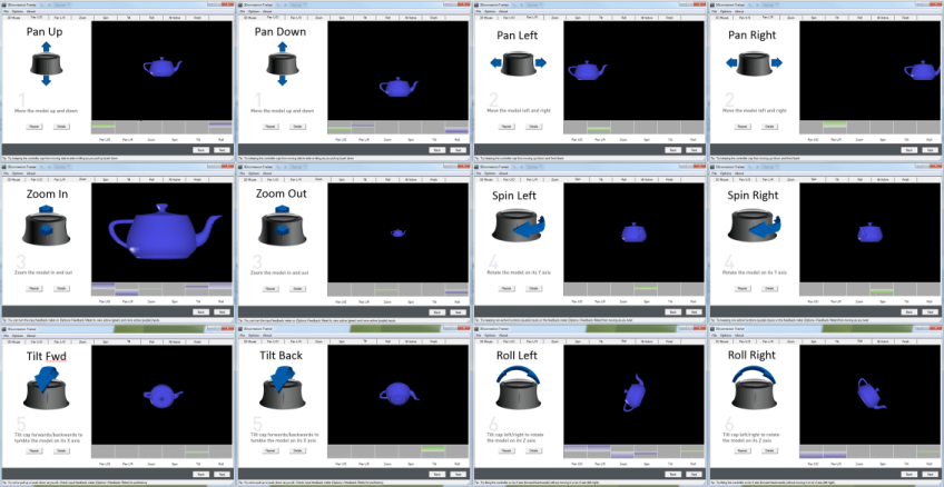

It seems like the sensors on my SpaceMouse are all hosed. I tried calibrating, restarting windows, reinstalling the driver, but nothing works. Below are the results of sensor feedback I get in the Trainer. Sorry about the low resolution, but the forum limits file size and the number of files. FYI I'm on version 10.6.4 on Win7. Is my SpaceMouse just dead in the water?

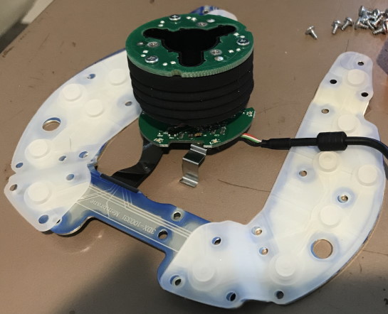

Update: SpaceMouse is all fixed up. The suggestion to clean without disassembly was misguided. This was definitely an issue with dirty optical sensors, and you can't clean the sensors without disassembling. In hindsight I probably could have gotten away with just removing the puck and leaving the rest of the device alone. At least on this model there are screws under the circular cap that allow you to remove the puck, but I didn't know that till after the fact. Once the main sensor assembly (2 boards connected by springs and covered by a shroud) is exposed, it was just a matter of cleaning the sensors' surface with a qtip and isopropyl. Good as new!
