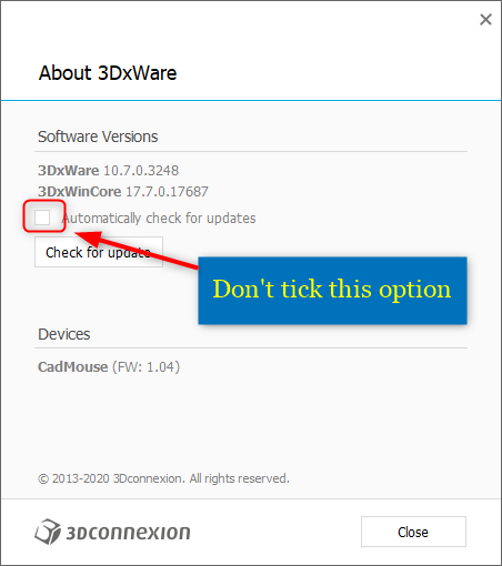

H heikkuri,
heikkuri wrote: Sat Sep 19, 2020 11:05 am Some option during the driver installation, perhaps?
Uninstall 3DxWare 10 (the settings will be preserved) and re-run the installer: expand the "Advanced Settings" section and clear (untick) the option "Automatically check for updates".

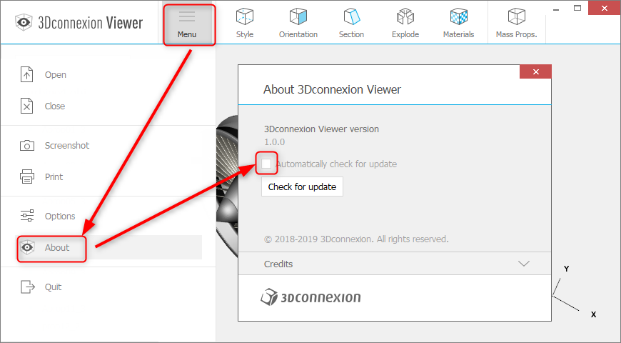

luping
Posts: 1059
Re: How to disable automatically check for updates
Post by luping »
Go to 3Dconnexion Properties, and go to 3Dconnexion Viewer:
