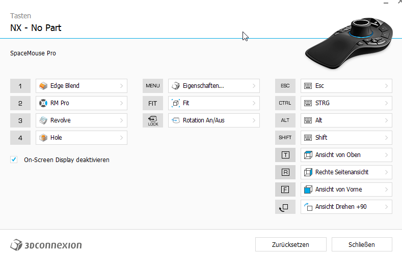

But trying to customize buttons 1 to 4, there is no NX application available:
2020-11-10 13_06_02-3DConnexion Macro Editor.png (42.31 KiB) Viewed 5653 times
I tried all folder from v8 to v1926 but it doesn´t work. But one thing is a little bit crazy. While starting NX, the NX application will be shown in 3dConnexion configuration overview.

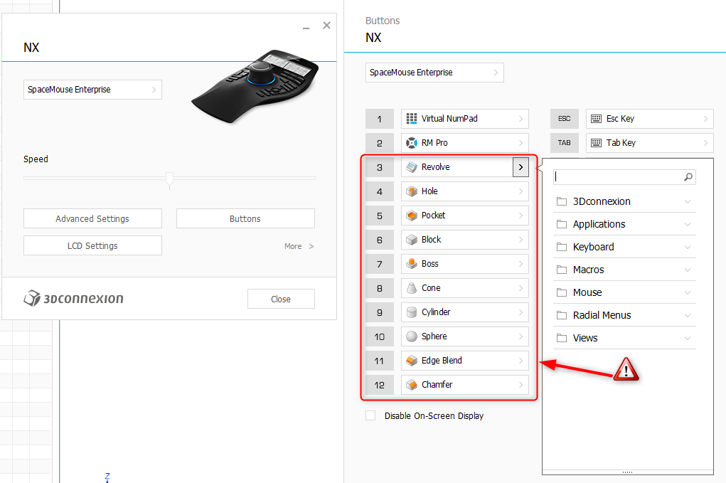

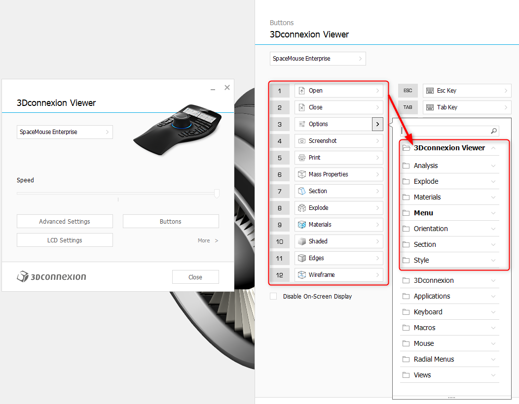

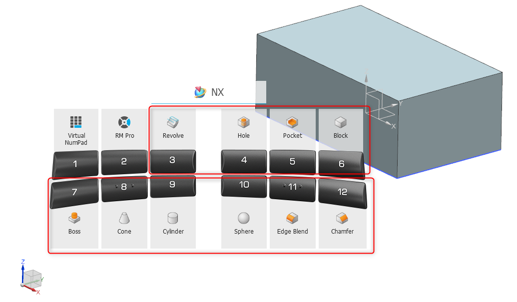

For the NX thing, actually I happened to have the opportunity to test the latest v10.7.0 on NX v1892(belongs to 1872 series), I lent one of my SMEs to one of my friends to try the SME out. As the test showed, 10 out of the 12 Intelligent Function Keys were assigned as NX modeling commands, while in fact they can not be activated in NX modeling workbench.
Check the below screenshots for yourself. The 3DxWare v10.7.0 just doesn't recognize the NX menus/commands as it does on the 3Dconnexion Viewer, no NX menu/commands whatsoever. The 6DOF cap works.

NX v1880 is actually a bug-fix release for NX v1872, NX v1892 is a bug-fix release for NX v1872 with more bugs being fixed as well, even more stable for production use. Usually the initial major/milestone releases come with lots of bugs, it's so bug-ridden that it's not suitable for production environment deployment, instead the following bug-fix releases are used in real world production environment. In this case, NX v1880, as well as v1892.
What m2privat complained is that 3DxWare detected NX workbench partially, the shown Intelligent Function Keys in the SMP 3DxWare control panel Buttons window(1-Edge Blend/3-Revolve/4-Hole) do not support NX commands to be activated, they just appear to be there while in fact do not support the NX modeling commands. For SME with 3DxWare v10.7.0 x64 in NX v1892 modeling workbench, the following commands can not be activated:
3-Revolve
4-Hole
5-Pocket
6-Block
7-Boss
8-Cone
9-Cylinder
10-Sphere
11-Edge Blend
12-Chamfer
It also not possible to change the assignments of Intelligent Function Keys for NX commands, the sub-menu for the Intelligent Function 3-12 simply show no NX application and its sub-commands. I suppose 3Dconnexion developers don't know how unstable the v1872, v1899, v1926 releases are. So please add support for v1880, v1892, or other bug-fix maintenance releases.
