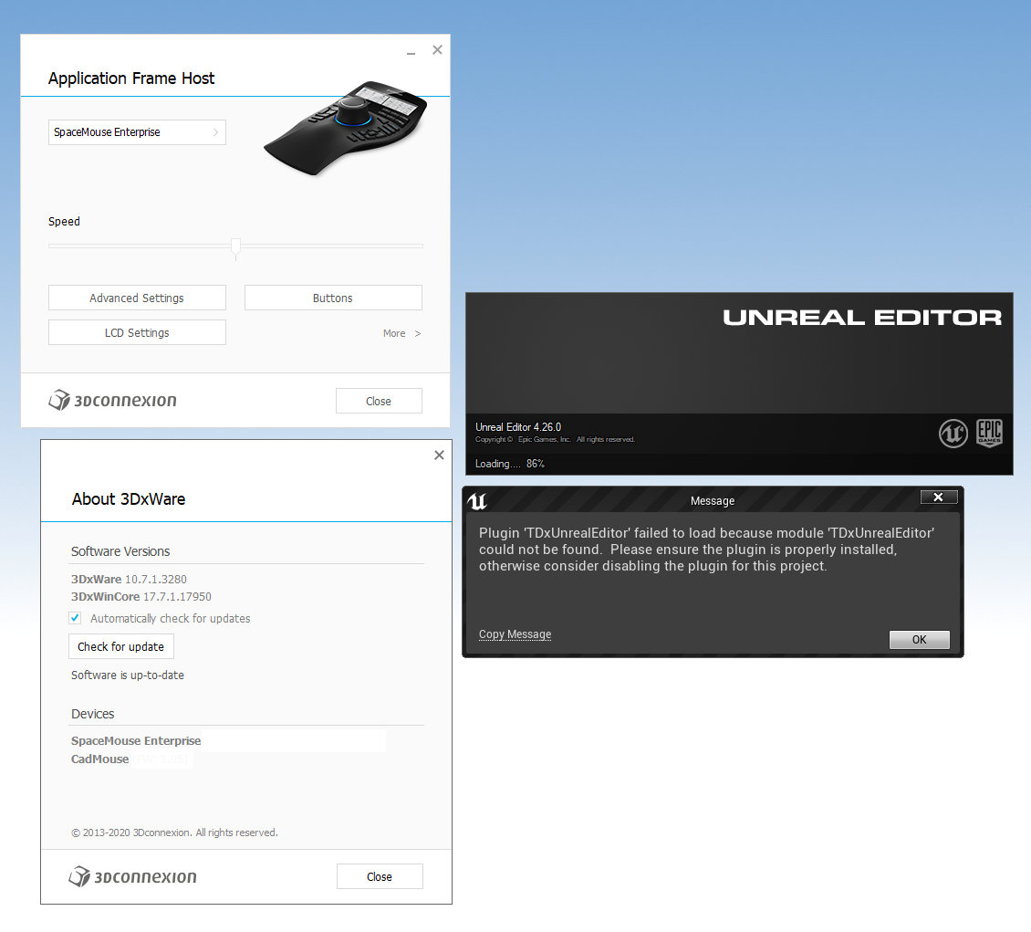

Very good to see that the new 10.7.1 driver has an Unreal Editor plugin.
Installed the new driver and checked the Unreal Editor automatic install.
Launched Unreal Editor but during the load process got this error message
Plugin 'TDxUnrealEditor' failed to load because module 'TDxUnrealEditor' could not be found. Please ensure the plugin is properly installed, otherwise consider disabling the plugin for this project.
I've checked the Unreal plugin folder and there is a 3Dconnexion folder in there for the plugin.
I have raised a ticket with 3Dconnexion support but while I wait for an answer wanted to see if anyone else has the same issue.

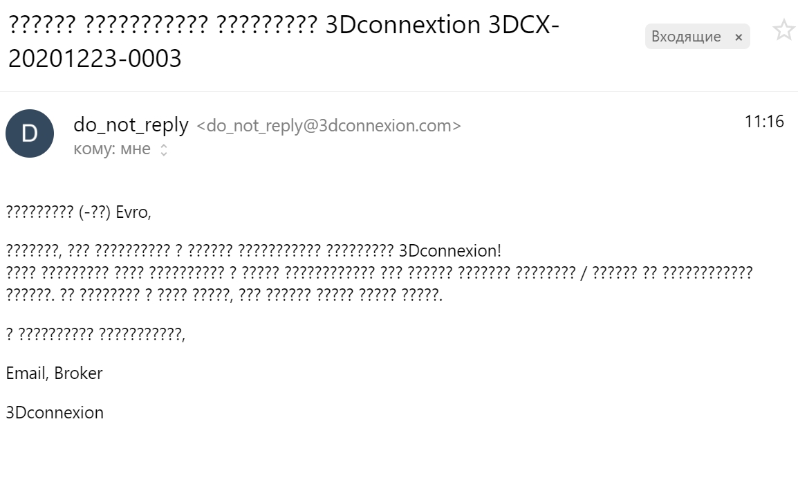

Сделал заявку в техподдержку, и спустя несколько дней получил ответ (скриншот).
Image 004.jpg (164.34 KiB) Viewed 14815 times

I am very sorry for the confusion. Your request was sent with Latin characters and the website tried to translate them to Russian characters. :D
Your request was escalated to the next level of expertise. Please bear with us as some of us are currently on vacation due to the Christmas season.

Same here. Unreal 4.26 just refuses to start until I uninstall the drivers.

Hi,
Firstly, our apologies for not getting back to you on this issue any sooner.
When we shipped the plugin for Unreal Editor, version 4.26 was still in pre-release. This means the "BuildId" number of the plugin module does not match the application, triggering the "failed to load" error.
Since 4.26 has now been released, we should be able to rebuild the plugin with the compatible "BuildId" just like we have for engine version 4.25 and older.
In the meantime, I suggest the following:
  1. Close Unreal Editor v. 4.26.0.
  2. Ensure you're running the release version of 4.26 (not a beta or other pre-release build; if necessary, check the application's "Build.version" file in the "Build" directory).
  3. In File Explorer, go to "<Unreal Engine 4.26 installation>\Engine\Plugins\3Dconnexion\TDxUnrealEditor\Binaries\Win64".
  4. Open the "UE4Editor.modules" file in a text editor (notepad.exe, say).
  5. Change the "BuildId" number to "14830424" and close the file.
  6. Start Unreal Editor and load your project.
Alternatively and if you do not wish to use the plugin, simply delete the "3Dconnexion" folder in the "<Unreal Engine 4.26 installation>\Engine\Plugins" directory.
