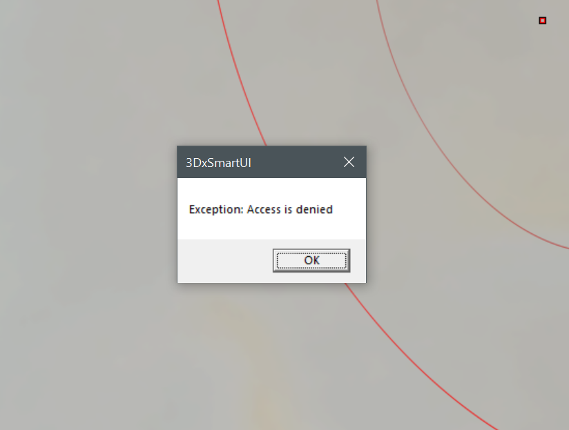

I am using space mouse pro. This popup is truly annoying thing since it is popping up constantly when you use Zbrush and want to mask hide and show parts of your mesh. Basically you do this all the time so I cannot emphasize more about how annoying this is.
I have found two tolerable solutions for this.
1. if you have two monitors move the popup to second screen like Vaell is doing.
2. When Zbrush window is active, press first shift and ctrl on spacemouse and then press alt from spacemouse and repeat pressing the alt key fast until you get error message
Sometimes you have press the shift ctrl and alt quite many times but eventually the error appears. Don't close the error dialog, just let it be in the background and it wont bother you anymore, nor does the popup appear. Sometimes the same error dialog appears again but not too often and usually they stay in the background.
at least the original popup does not appear again..
I am using 3DxWare 10.8.3.3389 & 3DxWinCore 17.8.3.18895
