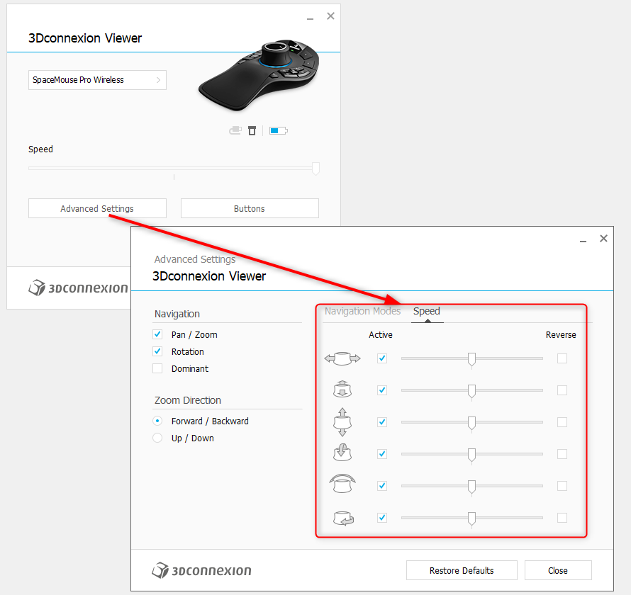

When in Google Earth application window, call out the 3DxWare driver 3Dconnexion Properties window, slide the speed slider to left a bit to slow the torque.
See the below screenshots for yourself.
speed slider 1.png (25.46 KiB) Viewed 3820 times
speed slider 2.png (65.45 KiB) Viewed 3820 times
