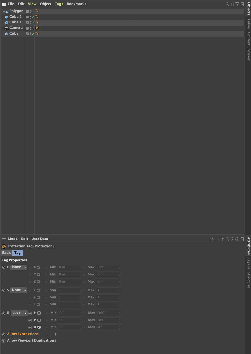

In 2019 the problem unfortunately still persists, changing roll left/right in the 3Dconnexion app has no affect in cinema 4D. One remedy is however to use a camera for viewport navigation and apply protection tag to it. In the protection tag you can lock Bank rotation. This way you can lock horizon within camera.
Screenshot 2019-11-1.jpg (70.53 KiB) Viewed 18303 times

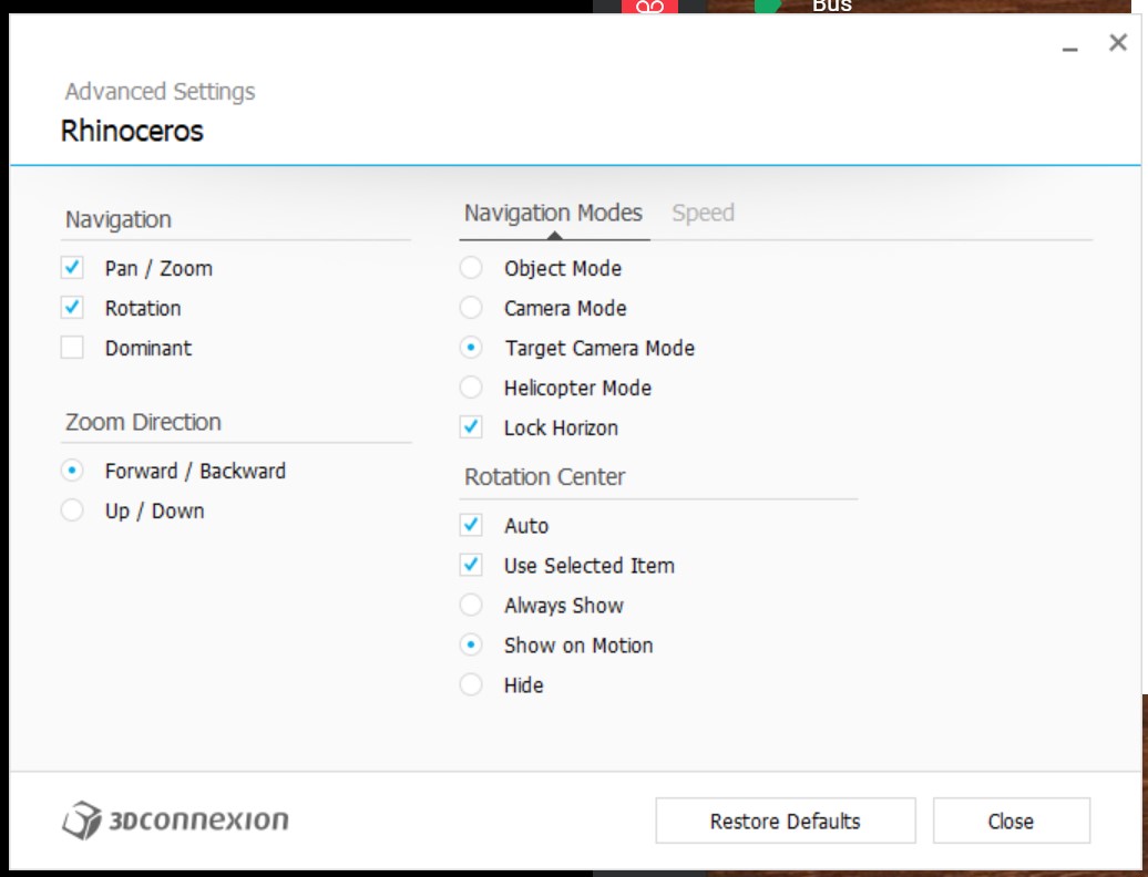

I just came across this after searching for a way to enable horizon lock in Cinema4D (and Blender).
Just because there is some confusion around it. What Maxon and Blender need to do is to enable something so that in the 3Dconnexion settings you get access to the "Navigation Modes" menu.
We use Rhino and there you have that option including the "Lock Horizon" option. It also appears for 3DS Max.
