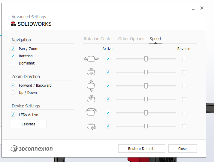

I'd like my space mouse to function in MS office 365 (& else where) the same as it does with the default Solidworks settings (ignoring rotational movements).
Default SW scheme:
Screenshot 2023-04-13 121920.png (38.69 KiB) Viewed 5278 times
Where translations of the mouse = translations on the screen (& rotations of mouse = rotations on screen)

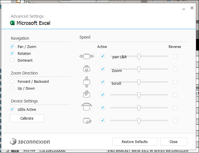

The default excel control is that translations of the mouse = no effect, rotations of the mouse = translations on screen
The excel defaults with my desired controls overlaid:

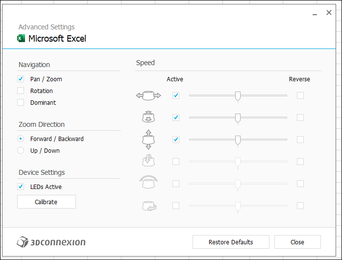

Changing to what I would expect would be what I need below, makes the mouse stop working all together. Buttons work, but no screen motion from mouse translation or rotation.
Screenshot 2023-04-14 135043.png (29.9 KiB) Viewed 5278 times
In fact, simply ticking either of the zoom direction radio buttons causes the whole thing to stop working also.
