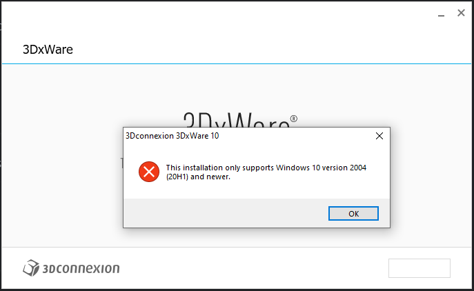

When attempting to install 3DxWare64_v10-8-15_r3625 or 3DxWare64_v10-8-16_r3641 I receive a failure dialog box stating:
"This installation only supports Windows 10 version 2004 (20H1) and newer."
3D Connexion Issue.PNG (15.91 KiB) Viewed 36839 times
I am on a clean build of Win10 Pro (Installed 09/18/2023 - Version 1903 OS Build 18362.356)
Is there a known solution for this?

As indicated in the message and as of version 10.8.15 of 3DxWare 10, the Windows 10 minimum required version is 2004 (20H1).
3DxWare 10 requires system resources that are only available in Windows 10 version 2004 and newer.
You can continue to use v. 10.8.14 of 3DxWare 10 in Windows 10 version 1909 (19H2) and older.
