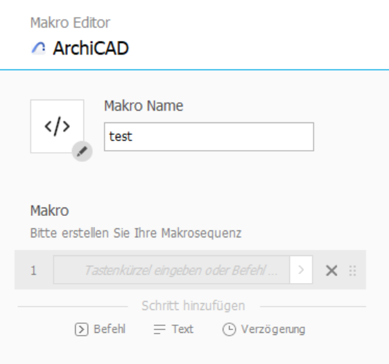

Re: Macro Keyboard Entry greyed out
it looks like this:
- Attachments
- can't input any keystroke...
- macroGrey.png (38.87 KiB) Viewed 6653 times
I finally figured out the reason.
I have installed the software "MacroToolworks" now "MacroCommander", here you can use shortcuts or keystrokes to extend texts.
First you have to quit this software, which runs in the background. Now it works as expected.
