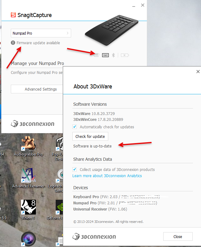

Thank you, but it doesn't work.
The NumPad is paired to the keyboard (there is a little sign where one can see the pairing.
No possibility to use ALT+ ASCII codes.
When going to settings there is stated: update available, going then to 'about' : software up-to-date!

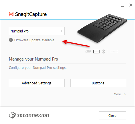

Hi EmilioS
Please click the sign 'Firmware Update available" under device selector in the 3Dconnexion window. You should receive a window with information to connect your NPP with PC by the cable in order to upgrade FW of the device.
The information "Software is up-to-date" reffers to the version of the 3Dconnexion driver not the firmware version of the device.
