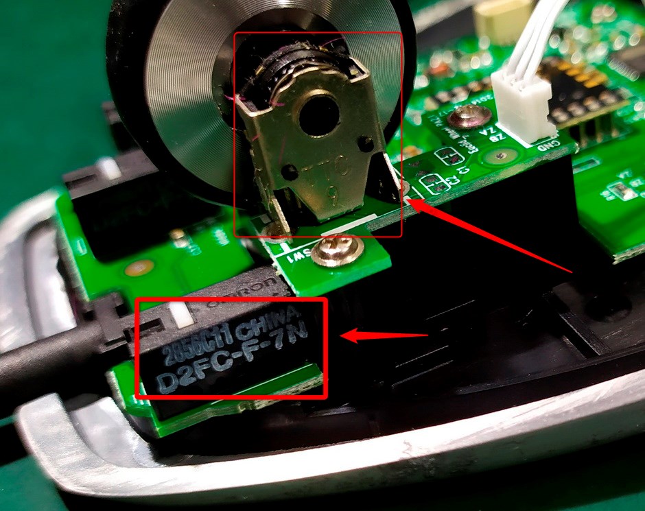

As for the durability of the switches, 3Dconnexion's PR news said that it has 50 million clicks, but actually it's mechanical durability, only possible if the micro-switch is not used on a charged electric circuit under certain testing condition. The actual durability of the micro-switches on a mouse depend on the electrical durability, it's only about 300,000 operations under testing condition, and in real world use condition, it probably lasts for up to 1000,000 or 1500,000 operations regarding the currency load(voltage, ampere) and your fingers' click frequency, lifetime clicks are less than 3% of the mechanical durability. Almost all mouse manufacturers, like Logitech, Razor and other brands, only display the mechanical durability. They can't make money if the mouses the manufactured has a longer life, it's a dirty industry secret.
For CadMouse, it uses Omron D2FC-F-7N switches, mechanical durability 5 million.
For CadMouse Wireless, it uses Omron D2FC-F-7N(20M), mechanical durability 20 millions.
For CadMouse Pro Wireless, it probably uses Omron D2FC-F-K(50M), mechanical durability 50 million.
Omron D2FC-F-7N/D2FC-F-7N(20M)/D2FC-F-K(50M) use silver alloy material for the contact in the micro-switch.

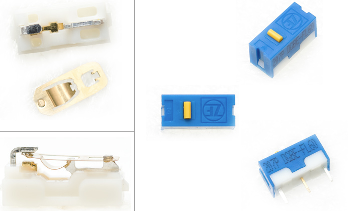

Other top micro-switches for you:
Omron D2F-F-3-7, made in Japan, silver alloy contact, around 10-20 million, with great feel for gaming.
ZIPPY DF3-P1L1, made in Taiwan, gold plated contact, 20 million, great feel for gaming.
After all, you have to try all the switches to choose the most suitable one for your own use.
ZF Gold Point Gaming Micro Switch(DGBE-FL60)
Description:
100% brand new and high quality
Material: Electrical Components
Color: See Pictures
Model: Gold Point-DGBE-FL60
Work: Optical
Interface Type: USB RS (port side) PS / 2
Optical resolution: Other
Whether to support ergonomics: Support
Key pressure: 0.74N (75g)
Service Life:60 million
operating force:50gf-80gf
Rated voltage: DC 5V 100mA
Operating temperature: -25 ° to +65 °
Compatible with most mouses

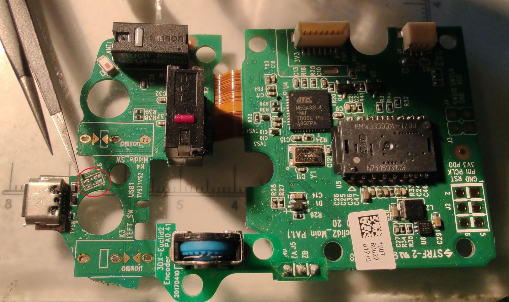

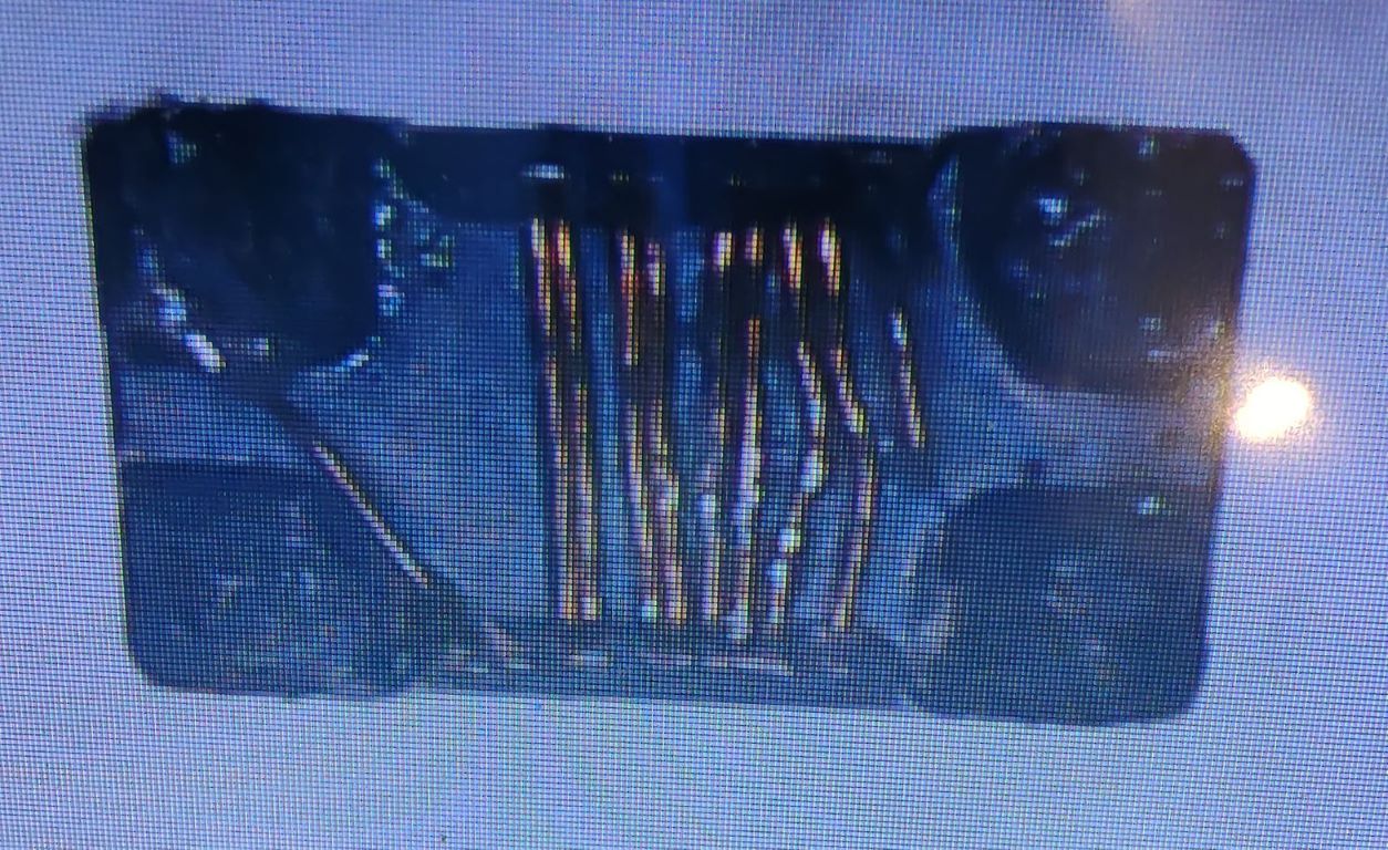

in fact, to my surprise, the mouse is still working.
In the meantime, I bought another CadMouse Compact Wireless (with usb c port) that I would have in case the first one died permanently.
Here are the photos of the component and its location on the board (this is a 2019 CadMouse Compact Wireless).
