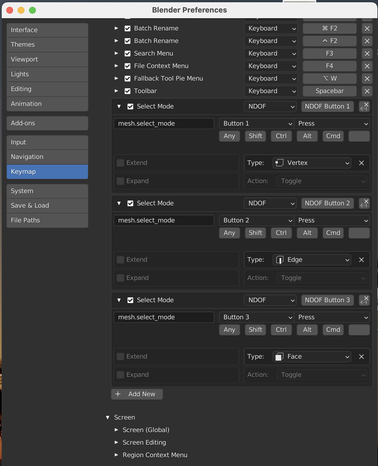

For anyone interested, here's how I got past this problem:
You actually have to call the correct function in Preferences>Keymap - scroll down to the key bindings. At the end of each section (I used "window") there is an "Add New" button.
Here's an example. I used button 1 to represent the number 1 to select vertices in edit mode.
Blender enterprise.jpg (174.17 KiB) Viewed 37409 times
Hope this helps someone because it wasn't intuitive to me. AND before you ask, I don't know all of the function calls. You can look up the keymap for what you want to activate. For example, I wanted to simulate pressing the "1" so in the search bar at the top of the keymap page I entered "1". Then I looked for the function call associated with a "1" press in the correct context.
