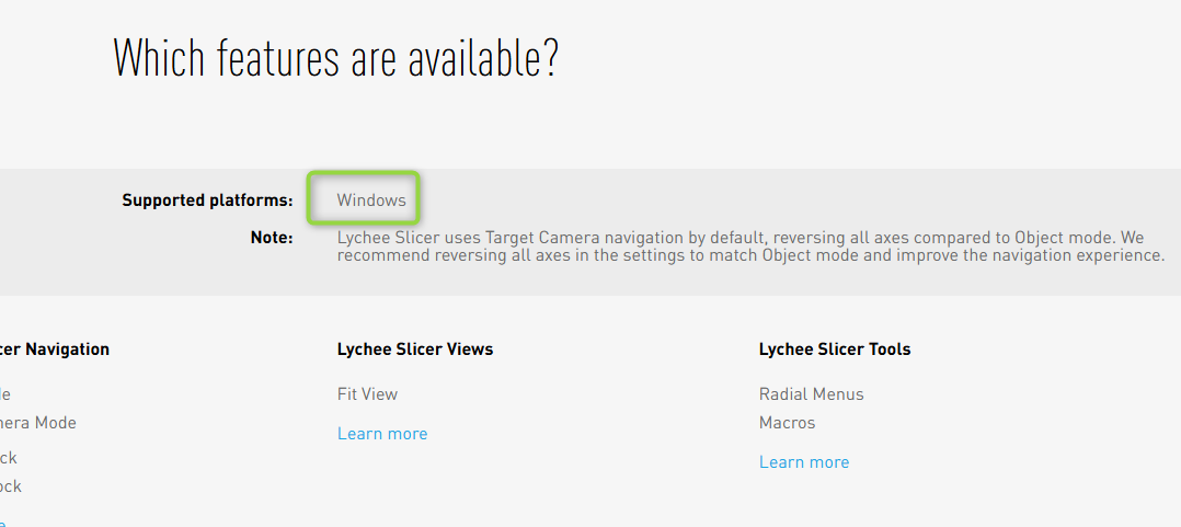

Unfortunately, right now we support Lychee Slicer only on Windows not on mac.
