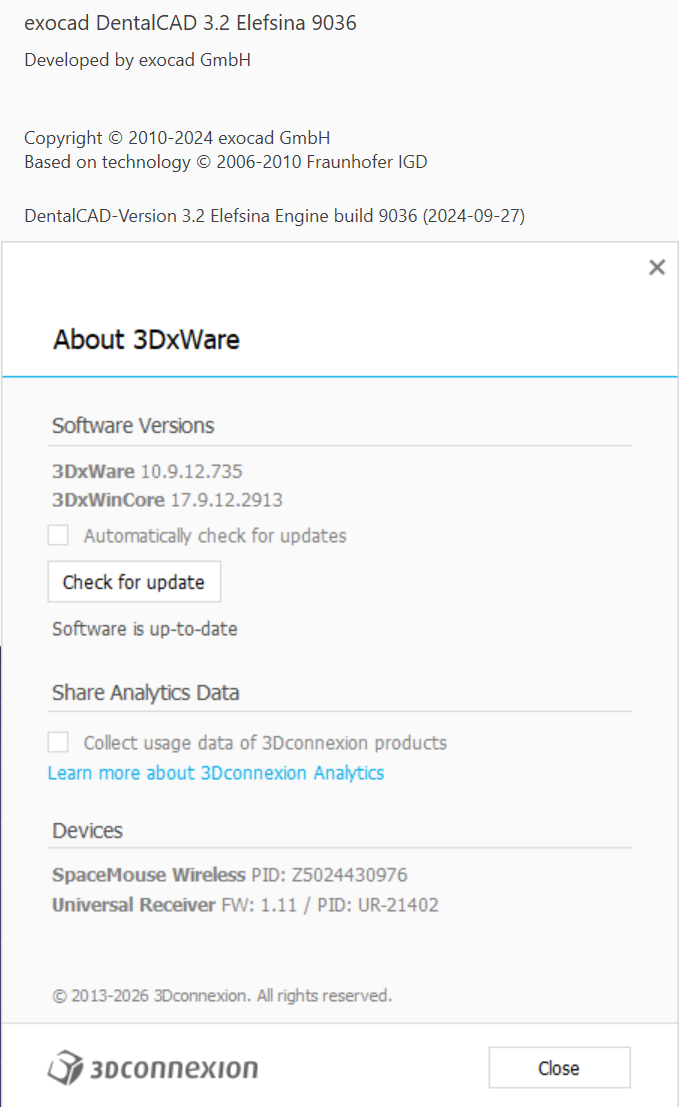

This is mostly Exocad. Version 3.2 build 9036.
3DxWare 10.9.5.693
3DxWinCore 17.9.5.21635
SpaceMouse Compact FW: 4.37
SpaceMouse Wireless only has PID in the program/
Universal Reciever FW: 1.11

I recommend you to update your 3DxWare driver. You can find it here.
Also maybe you turned on the dominant option in 3Dconnexion advanced settings for your SpaceMouse Enterprise/SpaceMouse Wireless

I installed it, but it didn't help.
