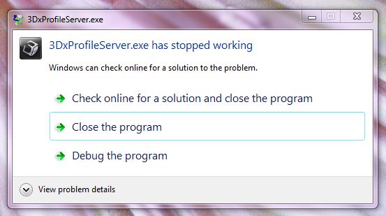

1 - Startup errors.
Frequently on startup I get error messages relating to 3Dx. I almost always get this one saying the server has stopped:
If I get that one, I often, but not always, get this one once I close it:

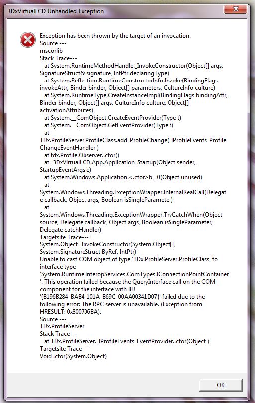

That one is usually followed by the first again. Once these are dismissed the device seems to work fine.
What is the cause?

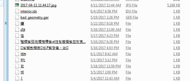

2 - Random Files in My CAD directory
My CAD directories are full of 1kb files generated by 3Dx with random, gibberish names:
If I open these in Notepad, they look like XML files. Here is a sample:
Code: Select all
<?xml version="1.0" encoding="utf-8"?>
<configuration><userSettings><_3dmouse.properties.settings><setting name="3DxPanZoom" serializeAs="String"><value>true</value></setting><setting name="3DxRotation" serializeAs="String"><value>true</value></setting><setting name="3DxDominant" serializeAs="String"><value>false</value></setting><setting name="Speed" serializeAs="String"><value>1</value></setting></_3dmouse.properties.settings></userSettings></configuration>

1 - Startup errors
We are tracking this issue with our internal bug number #7390. We will release a new driver with a fix for this issue (3DxProfileServer crash) shortly.
We are tracking this issue with our internal bug number #7389. We will release a new driver with a fix for this issue shortly.
