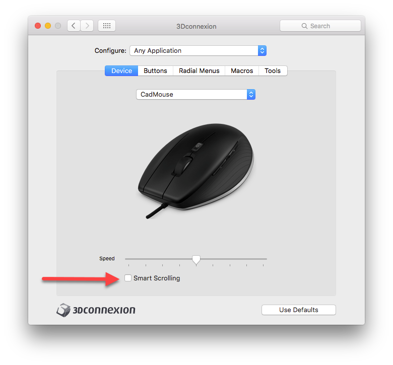

Re: CadMouse - Disable 'free wheel' scrolling?
Hi henke,
you can find in the 3Dconnexion properties in the device tab right under the speed slider a tickbox to disable the "Smart Scrolling".
Uta
3Dconnexion
3Dconnexion

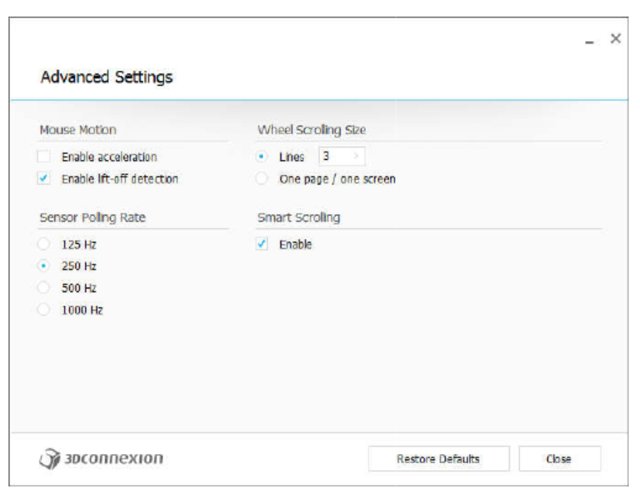

Tanks, but that doesn't do anything.
I found this manual claiming that there are Advanced settings where I can edit "Wheel scrolling size" from 'Lines' to 'Page'. I think that I would be able to fix this if only I could access the advanced settings for my CadMouse on my mac. But I can't find it anywhere…
https://fccid.io/2AAHQ-UR/User-Manual/U ... 91850.html
This is from the Windows driver - not from the Mac driver. See below:
