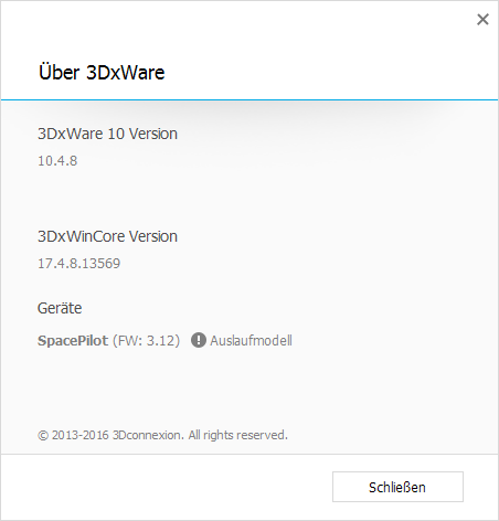

My PC is running on WIN 10 Pro 64 Bit and currently this version of 3DxWare:
I also tried older version for the SpacePilot Pro and the version 3.16.3 for the SpacePilot, but same issue with this versions. (I reinstalled the version by follwing the faq)
Does anyone has a similar working system? The LCD and controller head are working fine. Is there maybe a hardware issue?
Thanks for any advice!

Hi CatSailer1279,
3DxWare 10.4.8 recognizes the device correctly. Officially the last available driver for the SpacePilot is 3DxSoftware 3.16.3 which you tried as well. We did not take any steps to stop SpacePilot working in the current release driver, but it is not tested with it.
As you already tried several drivers and the device is shown properly in the device manager I assume that the buttons of your SpacePilot are not working anymore. Hardware issue - sorry.

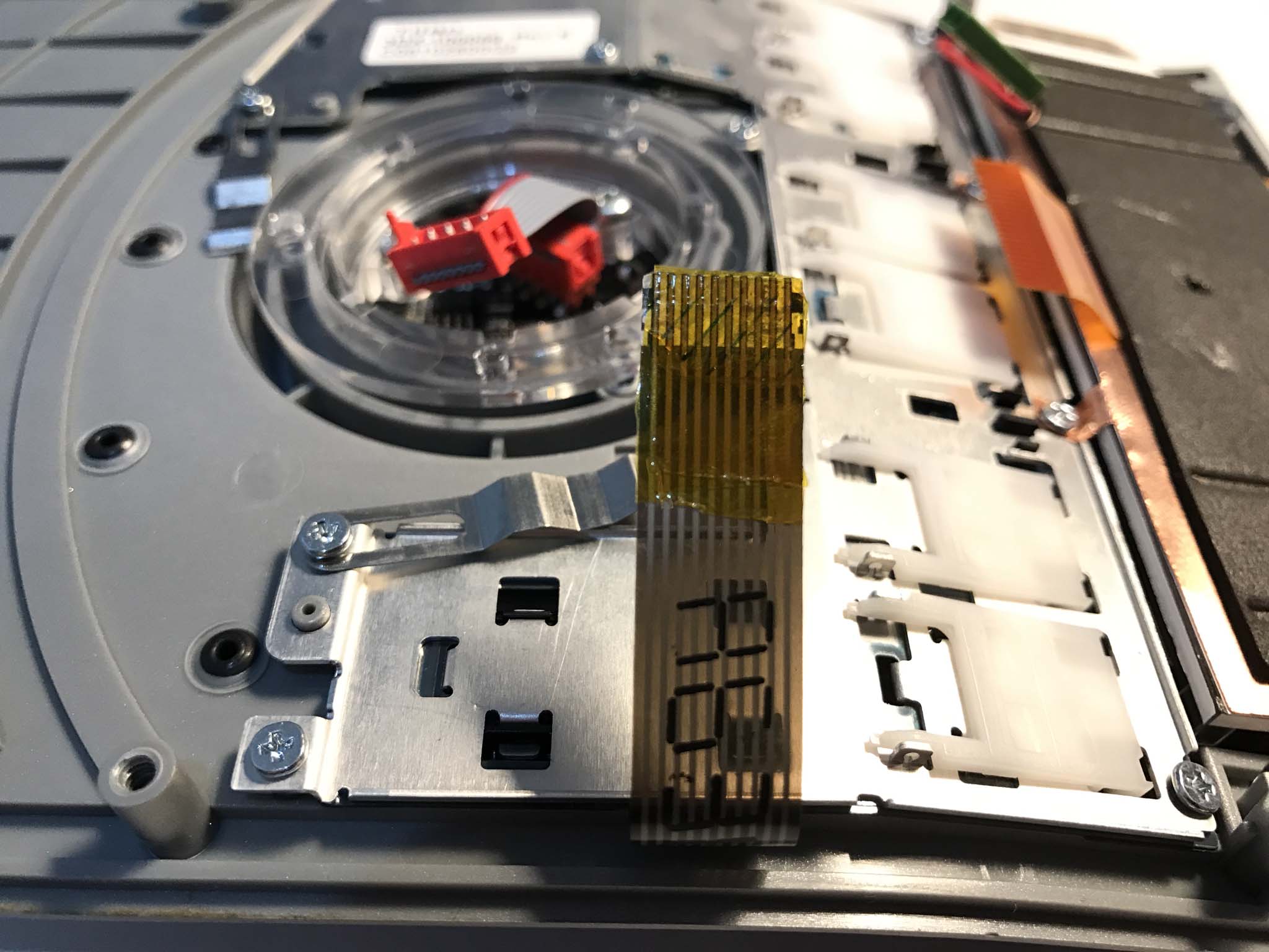

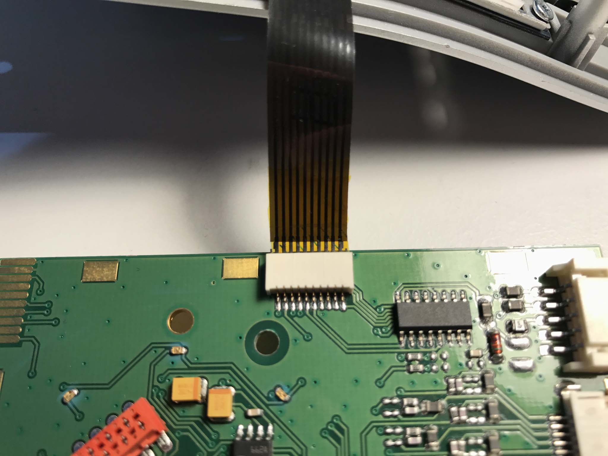

CatSailer1279
Posts: 3
Joined: Thu Jan 26, 2017 2:39 pm
Re: SpacePilot Keys Windows 10
Post by CatSailer1279 »
Thanks for answers!
It realy was a hardware issue. The connection of the ribbon cable in the socket of the keys was too lose and had no contact. I solved the issue with 3 layers of kaptopn tape at the backside of the ribbon cable.
Thanks for your help even on discontinued product.

nicksoph
Posts: 11
Joined: Tue Mar 13, 2018 6:10 am
Post by nicksoph »
Update - I received a working replacement from the company I bought the Pilot from and now have a working and a non working Space pilot which I managed to get apart and having followed a similar repair to above, it still doesn't work. Having searched on the web for a bit it seems the 3D Connection controllers are very reliable even after many years - well done.
