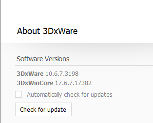

Version 10.6.7 was published a few minutes ago with the fix for WIN-650. You may download it from here.
@luping, thanks again for the detailed report and assistance in confirming the fix for WIN-650. Please do not installation the official version of 10.6.7 over the test build that you used last week. You should uninstall the test build before installing version 10.6.7 dated of today, April 27.

ngomes wrote: ↑Mon Apr 27, 2020 11:44 am Version 10.6.7 was published a few minutes ago with the fix for WIN-650. You may download it from here.
Just installed. All is OK. Thank You.

I just download the official v10.6.7 driver and gtt it installed, now it's working. Thank you!
