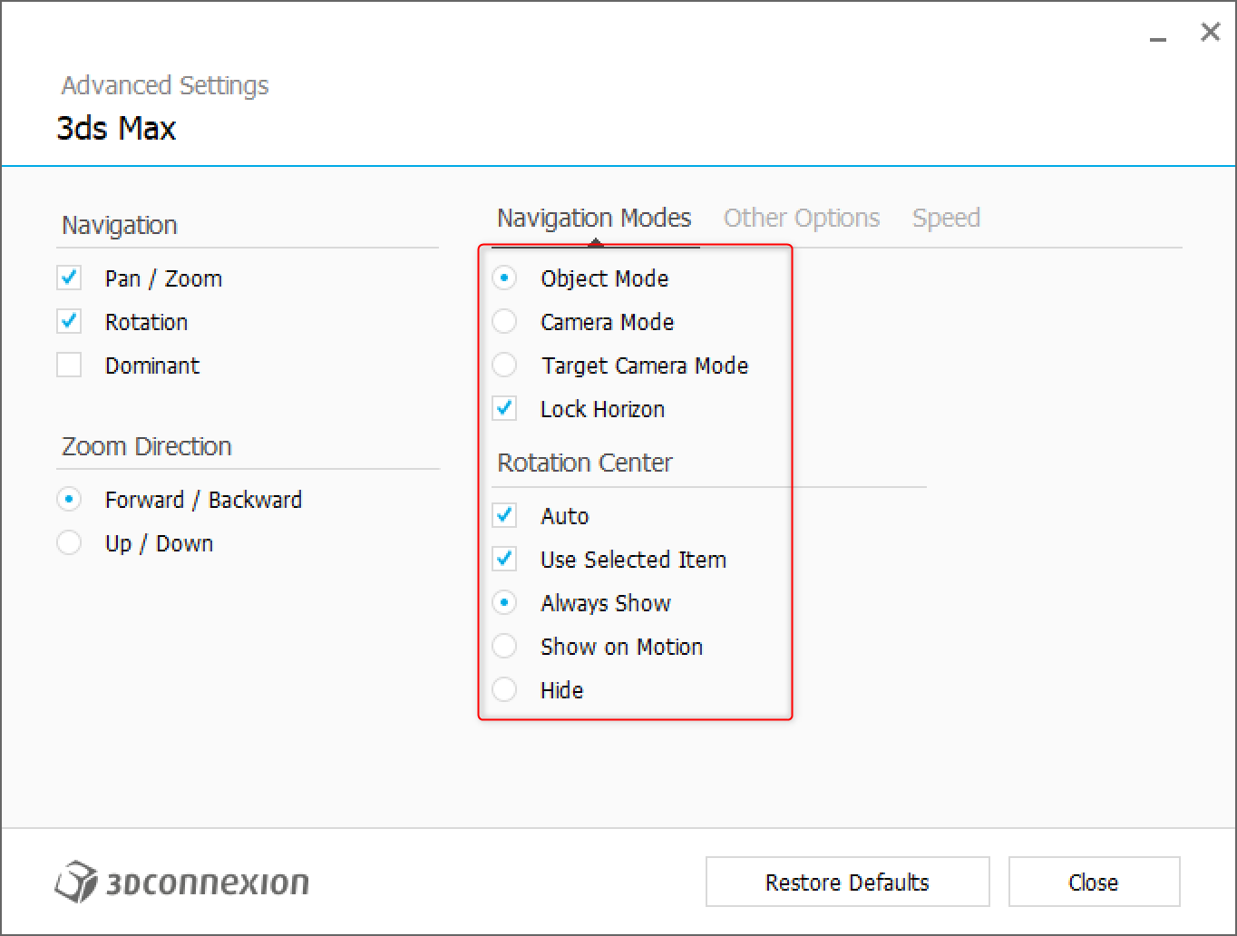

Lastly, could you tell me what navigation settings you have enabled in our control panel? I'm posting an example below to illustrate what I'm looking for.

Hi Zack. I open a Ticket to support the 03/07/2020 (CASE 11963). I send you the scene, video, setting...
Before to open the Ticket (I already had this problem on 3dsmax 2019 switching from 10.5 to 10.6 drivers) I reset my workstation: win 10 pro, max 2021 now with sp 3 (version 23.3.0.3201) , rhinceros 7, adobe suite, zwcad.
My configuration is CPU Intel Xeon Gold 6148 @2.40 GHZ - 192 Gb ram - SSD 1 Tb - Nvidia RTX 6000.
The setting of 3dsmax are the defautl (Standard and Default Shading).
The setting of the 3dConnexion mouse are the default (the same of your screenshoot)
For mitigate (does not solve) the problem is necessary deactivate in ROTATION CENTER - AUTO (I don't know why) but without the navigation is terrible: other setting don't change the set.
Today I update the new driver of Nvidia (460.89) but the problem is always the same.

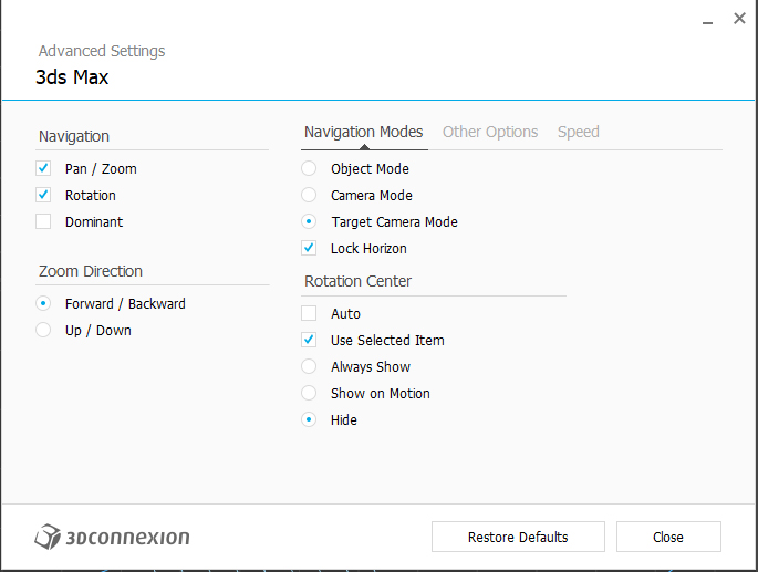

I have now recreated the issue with a very simple scene.
I have just a teapot and one vray camera in the scene.
When I have the camera viewport maximized and I zoom the curve editor with ctrl+alt+middle click, it always switches between viewport and camera and the creates keyframes in that frame.
Here's a screencapture of what's happening:
https://youtu.be/bxSwY1lQzGM
Also attached the Space mouse settings.
Please look in to this issue. This bug affects our animation workflow drastically!
