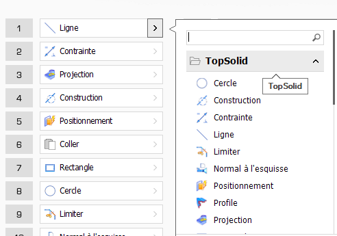

1) Custom mapkey icons are not displayed on the display, only the default (smiley) icon. I'd love to to see this implemented, since I have made many custom mapkey icons. This might be a Creo specific issue?AxeGunKnife wrote: ↑Thu Jan 18, 2018 2:50 pm I, too, could not customize the icons in the radial menu. I also asked the developer questions in other branches. But .... they did not answer me.
Re: Editor to assign custom icons
Eyy... Would you look at that! So much better than not having any icons...
I think the only icing on the cake would be the Screen changing depending on the workspace I'm working in ( Sketching, Solid, Surface, etc... )
For now, I went with the Solid one as it requires the use of the SpaceMouse the most while Sketching can mostly be done with the Keyboard.

I made a very simple editor to add icon to the SpaceMouse for software that don't do it automatically
Here are the step to do it :
1. Assign shortcut to the commands in your app (Fusion/TopSolid...)
2. Create the corresponding macros using the official editor
3. Backup your configuration file
4. Launch the 3DxConfigurationEditor 5. Select the configuration file to modify
6. The list of existing macro is loaded, select the one you want to add icon to.
7. select the icon to add
8. Validate
9. Your macro has an icon. In the editor the macro will be found under the App folder name has well has in the macros folder I have only tested it on my device and on TopSolid, therefore I don't guarantee it will work with other device or other software (I don't even guarantee it will work at all

I might add an option to select where to add macro entry, if people ask, if you had a list of the "Type" allowed in the xml that would be great.
I have also tried to enable creating the macro directly from my tool, has it would be convenient to create the macro and add the icon directly. Moreover, lot of programs allow exporting the preferences (including hotkeys), therefore it would be possible to parse those config file, and to create all the corresponding macro on the fly.
I have managed to create macro in my tool, I found that the keys are stored in the table using HID, however I am struggling with the keyboard layout. I am using an azerty keyboard, and when I type the key A, 3Dx stores the value "0x14" corresponding to the HID of the key "Q". How do you manage keyboard layout?
I have tried what you suggested by replacing the line :
<ButtonAction Type="App">
by
<ButtonAction Type="Macro" xsi:type="ButtonAction_Macro">
But got an error stating that an unknown namespace prefix was specified in the configuration file (version 17.7.2).
I have downloaded the latest driver from your website : 3DxWare64_v10-7-2_r3314
Any idea what's wrong?
I then tried removing the xsi:type="ButtonAction_Macro", as I suppose this was causing the error, no error then, but I still have both button listed (in the Macro folder this time obviously). Notice that only the entry without icon is modifiable.
I think the best would be to have it listed in the App folder (eg. Topsolid in my example), and to have the possibility to edit it here (and not having it in the macro folder).
