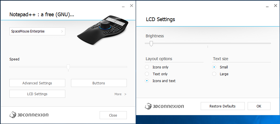

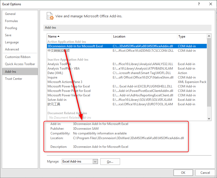

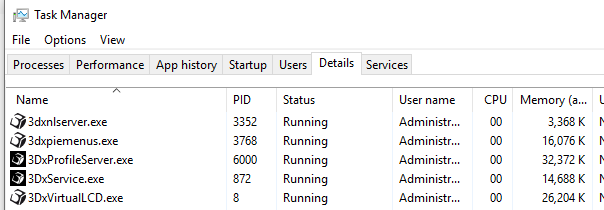

Thank you for you reply. Recently I switched to SME and cadmouse, I noticed that when I click 'Stop 3DxWare' to turn off SpaceMouse Enterprise, the LCD screen light is turned off, and when I click to run Microsoft Office Excel, the SpaceMouse Enterprise LCD screen is turned on and the 3DxWare tray icon appears, and several 3DxWare service related processes are running. MS Excel Loads the 3Dconnexion add-in for it, probably this is the reason why some 3Dconnexion application executable is trying to connect to Internet, it's the Windows OS mechanism working to verify the digital certificate. Just my guess.
