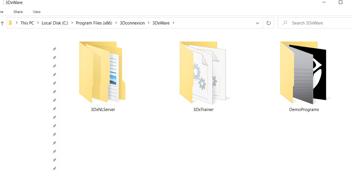

1. There is no 3DxUnreal\Plugins\ folder in that location on my system.
no folder.jpg (65.67 KiB) Viewed 9173 times

Sorry -- wrong screenshot was attached. (I have Epic Games installed on a separate drive. Though it still installs some folders on my C: drive.)
Still would like to know how I might go about installing the 3DConnexion software for UE 5.0.
