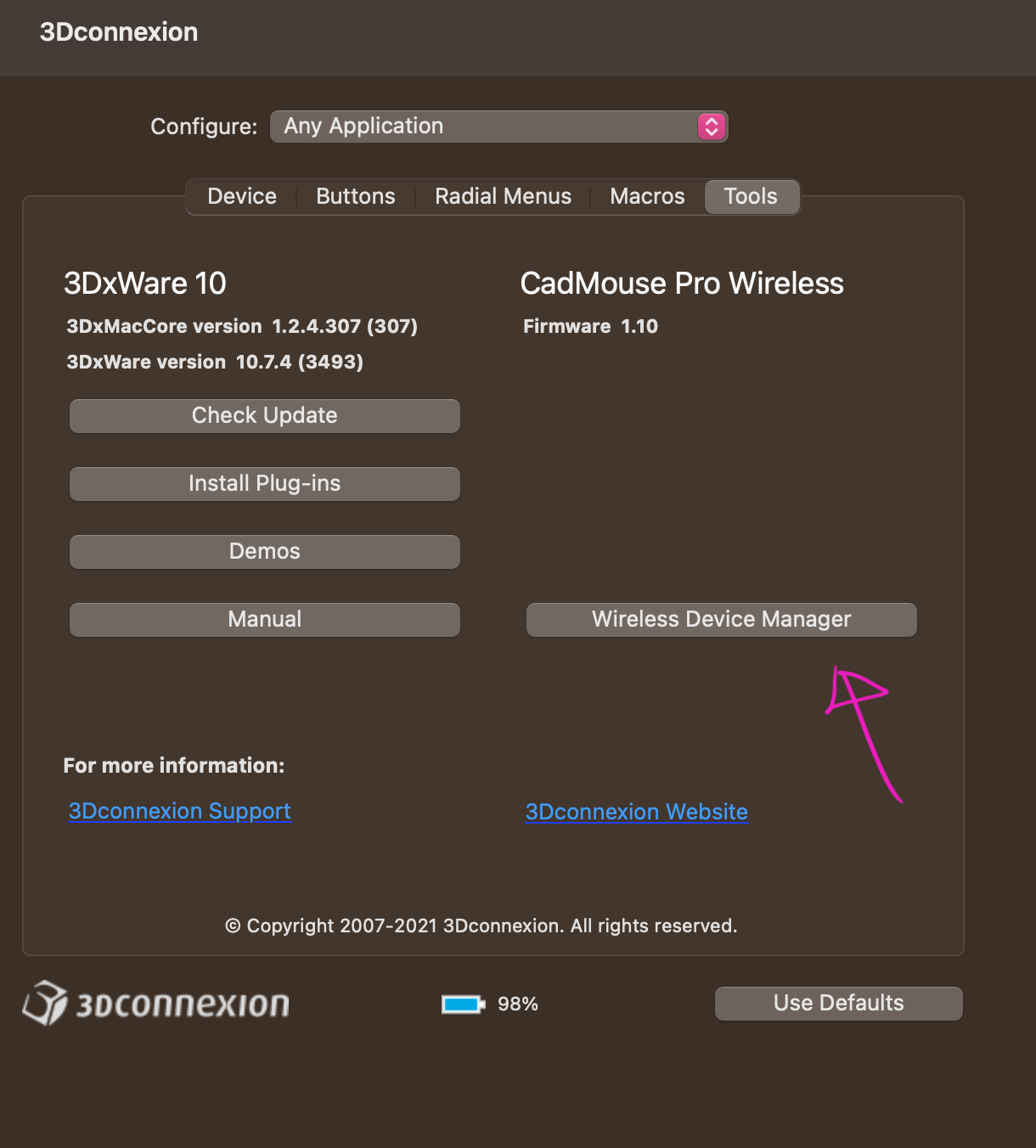

krishowes wrote: ↑Thu Feb 02, 2023 1:53 am System settings > 3dconnexion > Wireless device manager
Hello. By opening System Settings>3Dconnexion (Settings pane) there is no such a menu called "Wireless device manager". Can you please elaborate on where you found it?
krishowes
Posts: 7
Joined: Tue Jan 31, 2023 3:09 am
Re: Driver not ALLOWed to run in MacBook Ventura
Post by krishowes »
Hi I've attached a screenshot...
Screenshot 2023-02-09 at 08.24.49.png (129.69 KiB) Viewed 12804 times
