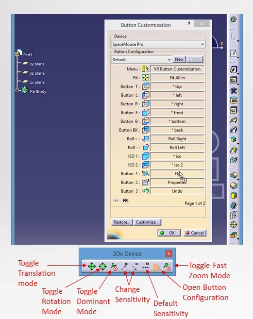

I am sorry that you encounter problems with your SpacePilot Pro. In Catia the buttons have to be mapped within Catia itself. You should get the appropriate window when you press the MENU button on your 3D mouse.
Catia Button Mapping.jpg (69.54 KiB) Viewed 17085 times
The Button Customization dialog box can be accessed from the 3Dx Device toolbar or by pressing the menu button on the device (default button mapping).
  • To assign a command, simply drag the desired command icon from one of Catia’s toolbars and drop it in the box to the right of the desired 3Dconnexion device button.
  • To map a Catia command that is not visible on a toolbar, right click on the desired box and select “Get Command,” select the desired command and press “Ok.”
  • To map a 3Dconnexion driver command, such as the Virtual NumPad, right click the box and select “Driver Command,” select the desired command and press “Ok.”
  • Default button mapping can be restored by pressing the Restore… button.
  • To restore or delete an individual button’s mapping right click the box and select either “Default” or “Delete.”
  • Multiple configurations can be created using the New button, allowing environment specific configurations. These can be selected using the drop down menu.
  • The second page of the dialog box can be accessed by pressing the Next Page button at the bottom of the menu.
  • When in the Button Customization Dialog box, hold down a button on the 3Dconnexion device to highlight and show what command is mapped. Holding down one of the function keys will show what commands are mapped while in Catia.
