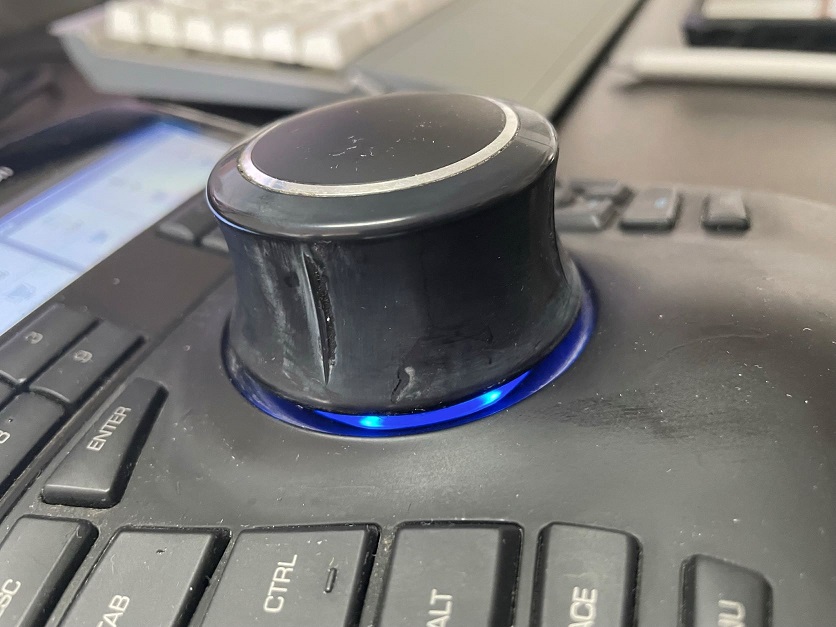

Bought a second hand Spacemouse Enterprise on Saturday, Monday tear down and full clean with IPA and microfibre cloth....very happy

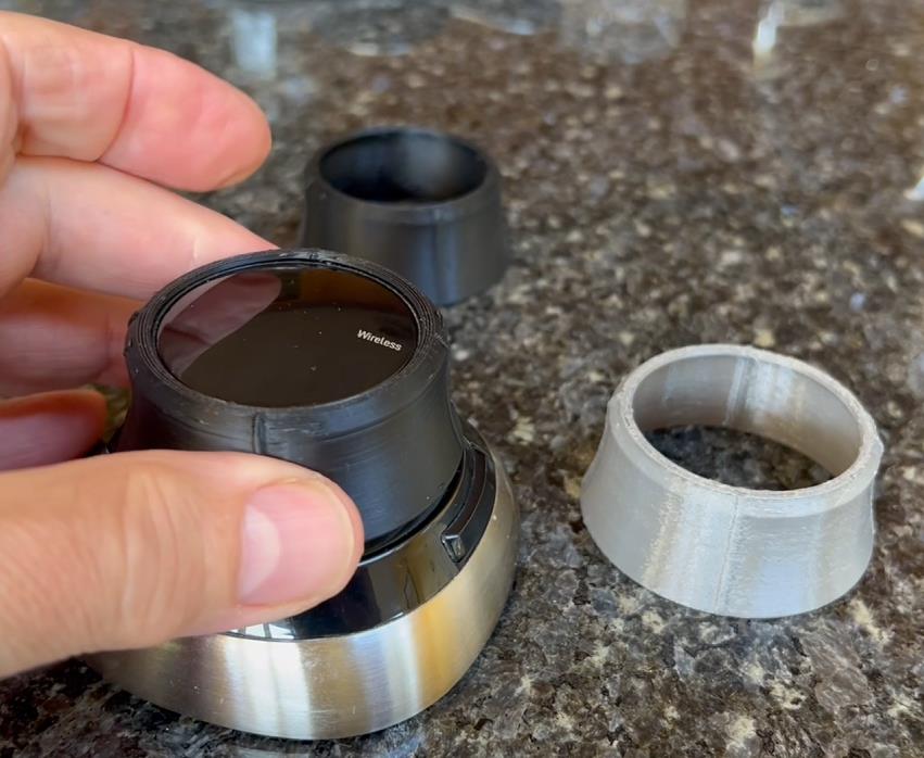

I've designed a 3D printed sleeve that fits over my Spacemouse (one for work, one at home).
I've listed it on eBay in case anyone else wants one, though not sure if I am allowed to post a link here?

https://www.ebay.co.uk/itm/166890300754dave_electric wrote: ↑Sun Jul 28, 2024 2:33 am I've designed a 3D printed sleeve that fits over my Spacemouse (one for work, one at home).
