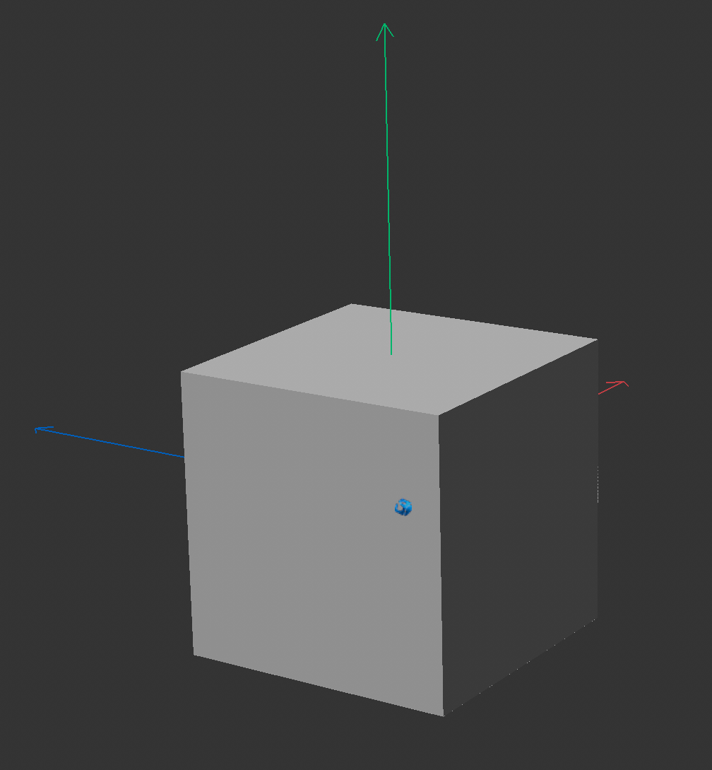

Works all right, but there is a strange little icon appearing when I navigate.
Screenshot 2023-04-01 at 16.20.30.png (45.9 KiB) Viewed 88469 times
Is there any way to remove it? Its annoying
