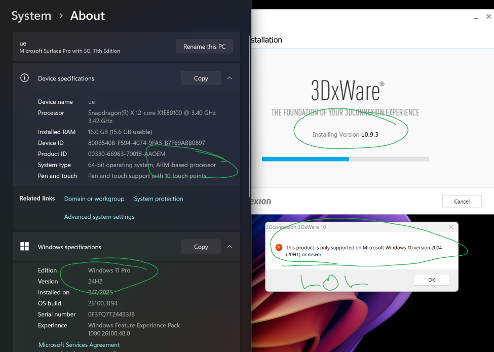

Where did you find 10.8.15 (or .14, per the compatibility note by @ngomes)? The latest version I see in the driver archive is 10.8.9 (and the current version appears to be 10.9.3).
Also this is such classic 3dconnexion. We waited forever for a bluetooth/USB-C Spacemouse that got rid of the infuriating USB-A "unifying receiver", now can't use it with current Windows hardware (in this case, Microsoft Surface Pro 11 first party hardware, not virtualized on a Mac). I'll check back in 2029 for a driver archive that actually includes all of the revisions of the driver :evil:

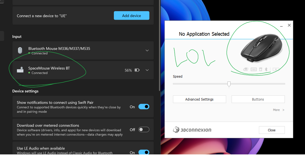

And finally, of course this doesn't work with the Spacemouse Wireless Bluetooth.. :evil: :evil: :evil:

There was a recent change to the installer check that may have addressed that specific issue. The change will be included in the driver of v. 10.9.4 of 3DxWare 10 currently under test.
Please note the "may have" caveat in the previous paragraph. Windows on Arm is not a supported platform.
You will want to check if version 10.9.4 is already available as a pre-release; specifically, if the software is available from 3Dconnexion's "Insider" programme. More information on the pre-release programme here.

Thanks @ngomes. I was not aware of the insider program, and have applied to test the fix for the

Thanks a lot for this link/program. I downloaded/installed this version and sure enough, my SpaceMouse Wireless BT Edition now works!! At least when plugged in via USB. I'm on an M4 Pro MacBook Pro with 48GB RAM running SolidWorks 2022, 2023 and 2024, and so far, Speed scaling and Button assignments work, although they don't seem to "take" when relaunching SW, sometimes requiring a tweak of the setting and switching back to SW, but it's now possible to work, so my hearty thanks for that. I'm guessing that the lack of BT functionality may not necessarily be you guys, and perhaps something in the chain from MacOS through Parallels v20.2.2 and into Windows 11. I'm hopeful that there may be enough ARM aficionados among the Surface and Mac bunch to warrant more attention. I'm grateful that you've opened up the beta program for this early fix, and I'm sure many on this list would be happy to endure some buggy drivers if it gave them an opportunity to give back with bug reports and accelerated development.

I downloaded 10.9.4 from the Insider Program Drivers page and I am happy to report that everything seems to be working!
I'm using Spacemouse Wireless (with receiver) on an M2 Macbook Air running Win 11 ARM inside Parallels. Setting speed, mapping and reversing axis, button assignments, radial menus all work for SolidWorks and Rhino 7. I only encountered a brief moment when all the axii reversed but that resolved itself once I opened up 3DConnexion settings.
Thank you devs!!
