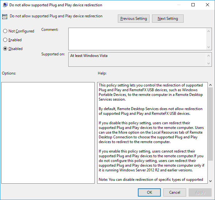

Re: Remote Desktop use of local Space Navigator
Not sure how to edit my last post but as a correction:
1. The enable setting needs to be on the client machine (home laptop for me) and the disable setting needs to be on the host machine (work desktop for me)
So two changes with gdpedit required, one on host and one on client
Also I needed to do a full restart on my client (home laptop) machine but only needed a gpupdate /force on my host (work desktop) machine
