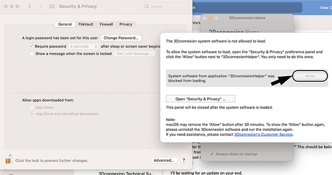

And that is precisely the problem, been through those steps numerous times. The result is always the same...
Screen Shot 2021-07-20 at 10.31.20 AM.png (177.09 KiB) Viewed 41201 times

garybart wrote: ↑Tue Jul 20, 2021 7:43 am And that is precisely the problem, been through those steps numerous times. The result is always the same...
Got it. I should have noticed that you were the customer reporting this issue yesterday (you already had mentioned trying to install repeatedly).
Check if the system extension file is copied in the required directory:
Code: Select all
ls -l /Library/DriverExtensions
Should return the following:
Code: Select all
user@mac ~ % ls -l /Library/DriverExtensions
total 0
lrwxr-xr-x  1 root  wheel  88 Jul 20 11:49 com.3dconnexion.dext.dext -> /Library/SystemExtensions/15233310-7B94-4060-BDA7-8D4164460F03/com.3dconnexion.dext.dext
user@mac ~ %
You can also try checking the logs in the "Console" app. Specifically, the "install.log" listed under the "Log Reports" category. See if there are any errors (we don't know what these could be) for "3dconnexion" or "dext" references.
