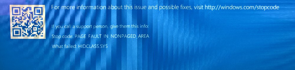

This is on Windows 10 Pro Insider Preview
Build 14986.rs_prerelease.161202-1928
Stop code: PAGE_FAULT_IN_NONPAGED_AREA
What failed: HIDCLASS.SYS
To reproduce:
1. Power on computer with 3D Connexion wireless nib in a USB port
2. Login
3. Start 3DxWare application
4. Launch Viewer within 3DxWare application
5. Select figure anywhere
6. Verify SpaceMouse connection by rotating or spinning figure.
7. Sleep computer (eg, C:\Windows\System32\rundll32.exe powrprof.dll,SetSuspendState)
8. Wake computer with keyboard press
9. Login
10. Receive Blue Screen of Death (BSOD) - picture under 256KB attached.
20161221 BSOD HIDCLASS small3.jpg (65 KiB) Viewed 6759 times

I just discovered this occurs regardless of whether I use the wireless nib or simply have the SpaceMouse Wireless plugged in with a USB cable. If I remove the SpaceMouse from the system, I don't get a Blue Screen of Death (BSOD).

As a Microsoft employee I have to tell you this is a bug in your driver. Typically this class of bug is easily caught by enabling "driver verifier" which will cause an assertion and error during driver development. You must pay attention to whatever driver code that does not run at PASSIVE_LEVEL to not have any data that could be paged out. Maybe this link will help your developers out: https://msdn.microsoft.com/en-us/librar ... s.85).aspx.

From what we have been able to gather, this "bugcheck" (BSOD) was resolved in Insider Preview Build 15002, released on Jan 9.
If you continue to experience such bugchecks in Build 15002 or newer (latest is Build 15031 released last week) when returning the system from sleep and SpaceMouse device or receiver is connected, please let us know by posting here or contacting 3Dconnexion's technical support team.
