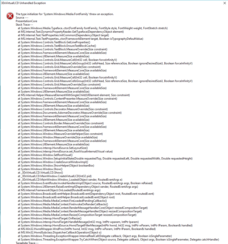

I'm having the same issue, which just started when I switched from a windows 7 machine to a windows 10 machine. Tried uninstalling and reinstalling 3dxware, and on re-installation got this error:
I'm not savvy enough to understand what it's trying to say, but it does seem to be related to the LCD.

irishmcsg2 wrote:I'm having the same issue, which just started when I switched from a windows 7 machine to a windows 10 machine. Tried uninstalling and reinstalling 3dxware, and on re-installation got this error: ......
raymonds wrote:I am having a similar issue.. I have been using the most up to date Drivers but as of a few days ago my LCD Screen is stuck on the Logo.. All the buttons still work and my navigation works fine..
Hi both,
the 3DxVirtualLCD Unhandled Exception error might occur when there is data corruption in the "user.config" file of 3DxVirtualLCD.exe.
To correct the problem, stop the driver then delete the folder [or folders] in the 3DxVirtualLCD folder that has the "user.config" files.
  1. Start -> All Programs -> 3Dconnexion -> Driver -> Stop Driver
  2. Delete the folder(s) named 3DxNumPad.exe_Url_... located at: "C:\Users\%username%\AppData\Local\3Dconnexion\"
Restart the driver. A new "user.config" file will automatically be created.
Do you get another error in addition?
