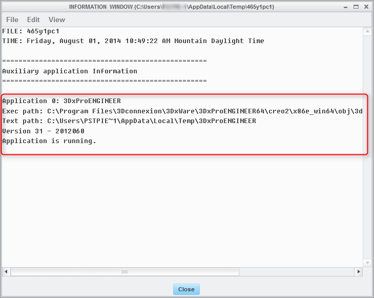

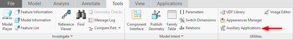

the navigation for Creo is native to the application and will work with a 3Dconnexion device as long as the basic driver (3DxWincore) is installed. However, the plugin is necessary for Creo commands to be mapped to the buttons and for environment specific mapping. The information provided by selecting the "Info" button in the Auxiliary Applications window found in the Tools ribbon will show if the plugin has loaded.
