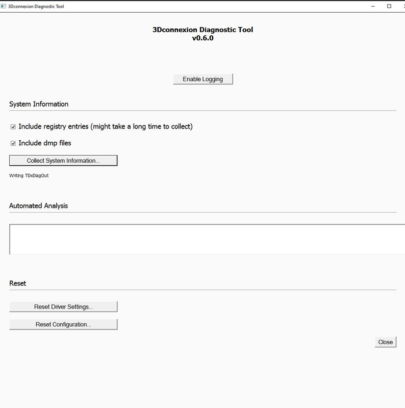

Gth
Posts: 13
Joined: Wed Nov 08, 2017 7:37 am
Re: 3D Connexion Ware does not start at Windows Startup
Post by Gth »
jwick wrote: Sun Oct 17, 2021 11:33 pm Hi Gth,
Could you also collect a file for me as in these instructions?
Thanks,
Jim
Thank you.
Alas the process of creation of diagnostic log could not been completed (see images).
