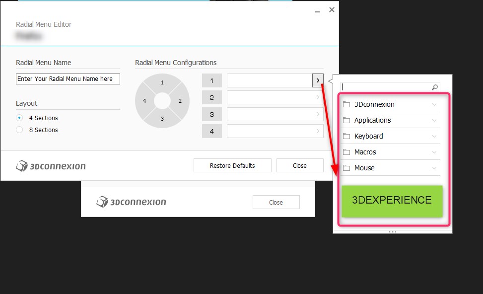

Make sure that the '3DEXPERIENCE' application name appears in the Radial Menu Configuration sub-selection list, as demoed in the below screenshot. If not, it's not supported. Then you must send your 3DxWare SDK APIs full implementation request to Dassault Systèmes, the 3DEXPERIENCE software vendor.

Act as the licence fee-paying customer and ask Dassault Systèmes to tell its software development team and/or outsource software development supplier in India to better integrate the 3DxWare SDK from here:
https://3dconnexion.com/us/software-developer-program/

luping wrote: Wed Jul 13, 2022 7:43 am Make sure that the '3DEXPERIENCE' application name appears in the Radial Menu Configuration sub-selection list, as demoed in the below screenshot. If not, it's not supported. Then you must send your 3DxWare SDK APIs full implementation request to Dassault Systèmes, the 3DEXPERIENCE software vendor.
3DExperience is the folder I'm picking from. Assigning commands from there to a physical button works as intended, just radial menus aren't working. I will see if my VAR for 3Dx is familiar with the issue.
