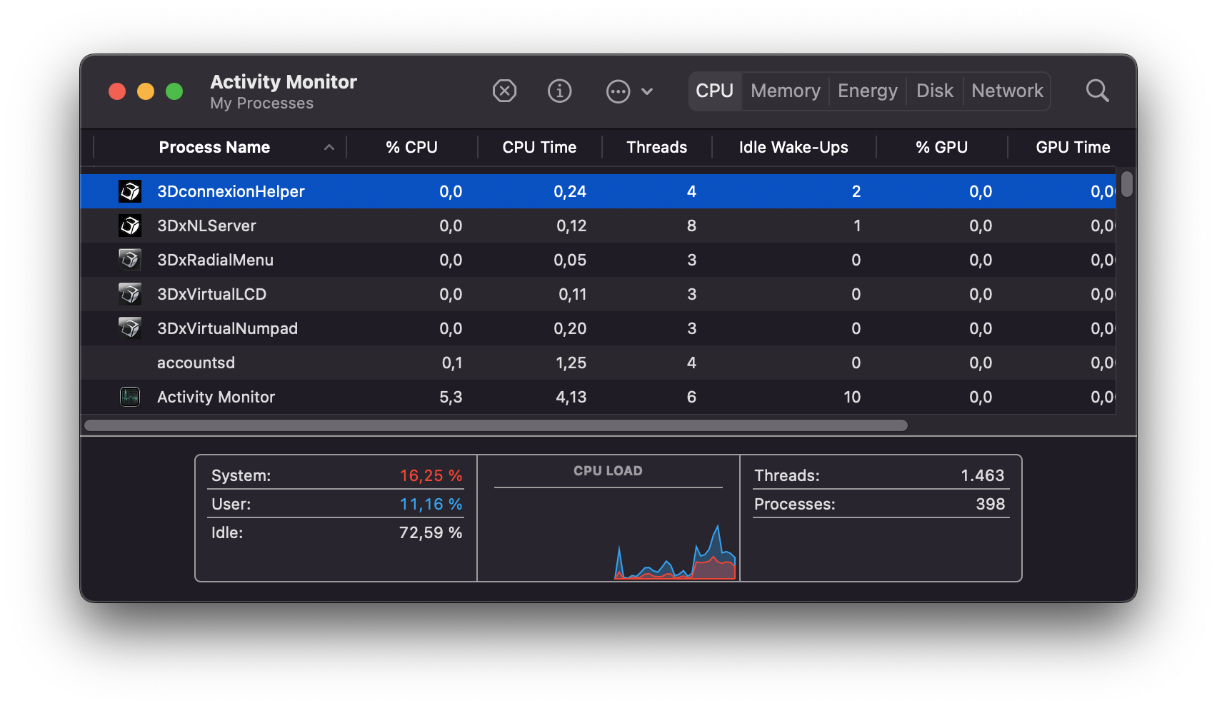

Re: macOS Sonoma
Verify in activity monitor that "3DconnexionHelper" is an active process. Please visit https://3dconnexion.com/support/faq/my- ... -on-macos/Ger wrote: ↑Sat Jun 29, 2024 5:02 am Hello,
