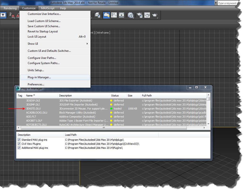

Re: SpacePilot Pro doesn't work in 3ds max
Hello vardaness,
please go to 3damax -> Customize -> Plug-in Manager and check if you have an entry for 3DXSTD.DLU and if it is loaded.

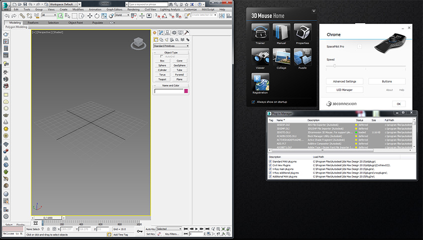

Yeah, its loaded already.
But still doesn't work((
Hello vardaness,
If 3dsmax is the active application and you move the mouse cursor over the 3Dconnexion icon in the system tray - what does the tooltip window show? Does it tell you which configuration is used? I saw in your screenshot that it seems that the driver doesn't load the profile for 3dsmax.
Please check if the buttons work in 3dsmax.
Let me know what you find out. Thx.
Hello, UtaSH.
You're right! The driver is not loaded for 3ds max.
And when I am changing the window to 3ds max, the driver is still showing Chrome.
BR
