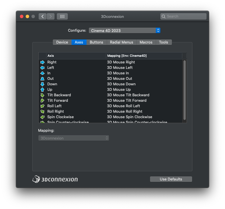

Now we have three issues:
1. Reversed axes.
2. Random loss of the reversed setting in the MacOS Settings dialog. If I just bring the Settings dialog to the foreground then back to c4d the navigation is again correct.
3. The oddness in tile/roll/spin function. E.g., when I attempt to spin ccw, trying very hard to only twist the knob on the SPE, the view appears to pan to the right. I have to add a relatively high pan-left force on the knob to keep the object centered. This also occurs in ZBrush and Painter but to a much lesser degree. However, the oddness does NOT occur when I work the puzzle provided in the 3Dconnection Home app.

Hi Greg,
sorry for my late response.
Regarding the inverting axes it may possibly be an issue with the mappings or existing (and therefore converted) mappings.
In 3DxWare for macOS 10.8.0 we've introduced a change to the mappings format and 3DxWareMac will convert existing mappings to the new format.
Maybe these steps can help to fix your issue (and maybe give us a hint on a bug):
- make sure the 3Dconnexiopn prefPane (i.e. System Preferences) are closed
- in Finder's "Go" menu select "Go to Folder..." and enter: ~/Library/Preferences
- in the now open Preferences folder look for com.3dconnexion.mappigs.plist and com.3dconnexion.mappingsV2.plist
- rename both, for example by prefixing it with "_" (this way you keep a copy of the files and 3DxWareMac won't see it anymore)
- since it's easier and less error prone: please reboot
Now start Cinema 4D and check if navigation / all axes are correct and stay correct.
I hope I could help you with this rather crude approach. I'm looking forward on reading your results!

Hi Greg,
so I've checked this now on macOS 12.6.2 and 13.3.1:
I also removed all config files, rebooted and started right away Cinema 4D 2023.2.0, i.e. 3DxWare for macOS v.10.8.0 had no (user) mappings file:
Motion is as desired / expected: Moving a cube cap left - moves the cube to the left, right - right, etc.
I then started the preference panel, selected Cinema4D 2023, checked the axes mapping
and closed the panel. Now the com.3dconnexion.mappingsV2.plist file is present.
I then restarted Cinema4D 2023.2.0 and got the same situation / behaviour: Navigation is as expected.
Don't get me wrong, but i have to ask you this (it happened to a colleague of mine as well *):
Do you have another version of Cinema 4D installed as well? And is the version you're experiencing the inverted navigation with really 2023.2.0 or this possible other version?
*) My colleague insisted this is 20230.2.0, but as it turned out he launched "Cinema 4D" via Spotlight and didn't look at the version information at all.
Last but not least:
- have Cinema4D 2023.2 closed
- navigate to the "3Dconnexion" folder and ther to "navlib".
- you'll find a file named "Cinema4D.user.config": remove it
- now please start Cinema4D 2023.2 again
Did the navigation change, i.e. work as expected?
On the LCD of your SpaceMouse Enterprise the configuration used should read "Cinema 4D 2023", in fact "Cinema 4D 2023 ( Cinema 4D )" is this the case?
I'm really out of clues now what could be the issue and I hope one of my guesses addressed your issue and I'm really curious what you find out!
Regards,
Christian

Hi Christian,
About Cinema 4D dialog at url below. You can see I have 2023.2.0 running.
No other version of Cinema 4D installed.
The LCD of the SPE does read 'Cinema 4D 2023 (Cinema 4D) when C4d is the active window.
I removed Conema4D.user.config and restarted C4D.
Nav looks great now!
Axes are normal sense. The oddness in tilt/roll/spin has gone away.
Nav is now much like other apps and the puzzle app!
Thanks so much!
Greg
