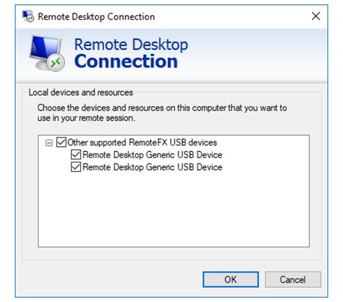

Now mine is set up it says in the remote desktop connection:
Other Supported Remote FX devices (Ticked box)
Then from that:
Remote Desktop Generic USB Device (also a ticked box)
